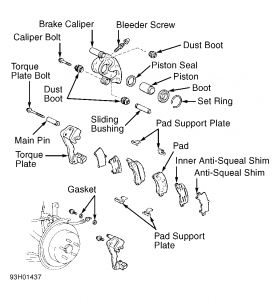

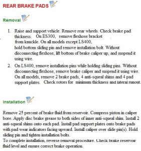

I need to know how to replace the rear brake pads on a lexus es 300. I have already replaced the front.
ps please send photos or diagram.
thanks
