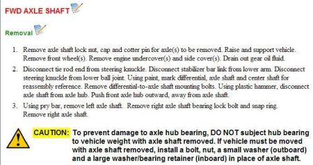

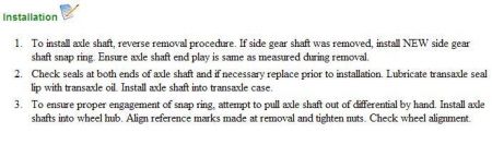

can you send me some pictures on how to replace the axel on drivers side axel for my 1995 es 300 luxus
