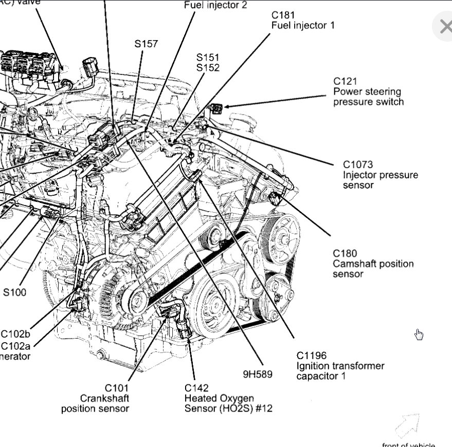

I can't find the left camshaft position sensor location.
Wednesday, August 7th, 2019 AT 5:20 PM
It appears your vehicle only has one sensor. I attached the location which is on the driverside. This is actually the left side because left and right are determined by sitting in the driver's seat.

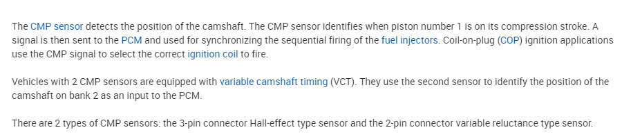

You only have two sensors when you have variable cam timing which I don't think you do.
Let me know if you have questions, check the images below. Thanks
