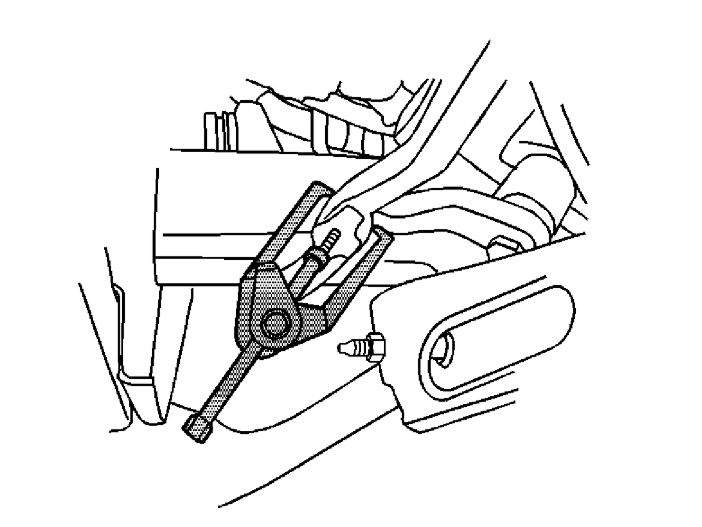

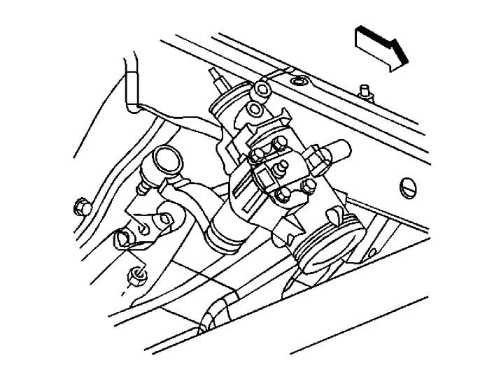

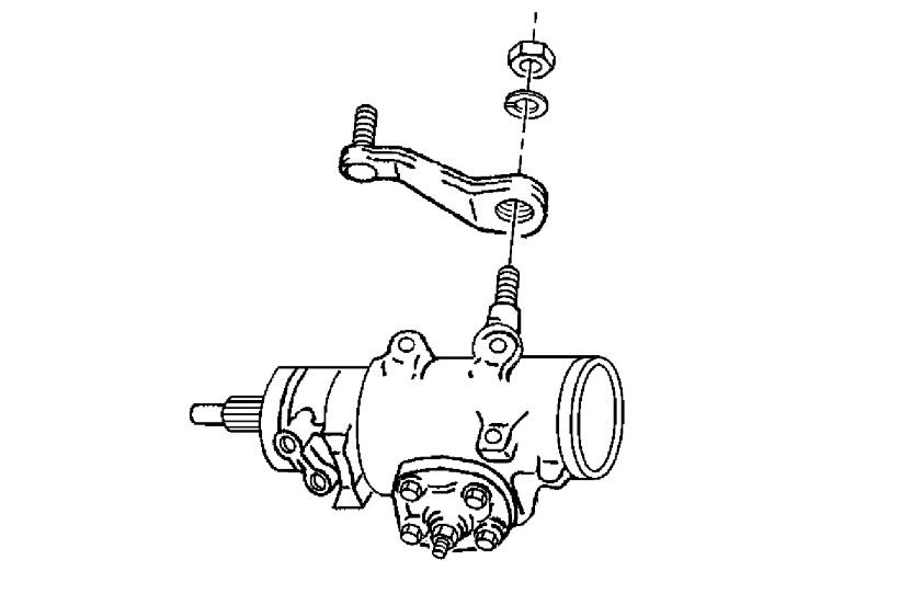

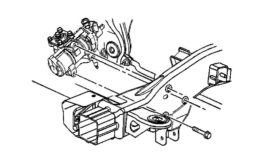

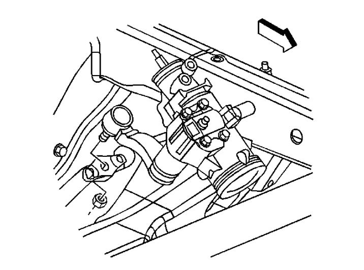

I replaced the power steering pump because was leaking six months ago and now the steering gear box is leaking.
How I removed the steering gear box in four wheel drive?

Not easy on the 4 wheel drive.
I also attached a youtube video for you to view. It is the same as yours just a different model.

4. Remove the power steering hoses from the steering gear.
NOTE: Refer to Power Steering Hose Disconnected Notice in Service Precautions.
5. Cap the ends of the hoses and the power steering gear in order to prevent any entrance of dirt.
6. Disconnect the intermediate shaft from the steering gear.
7. Remove the pitman arm to relay rod nut.
8. Disconnect the pitman arm from the relay rod using J 24319-B.
9. Remove the bolts retaining the steering gear to the frame.
10. Remove the steering gear from the vehicle.
11. Remove the pitman arm to the power steering gear retaining nut.
12. Remove the pitman arm from the power steering gear using J 6632-01 or J 29107-A.
