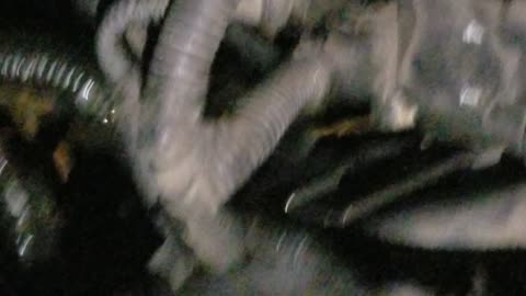

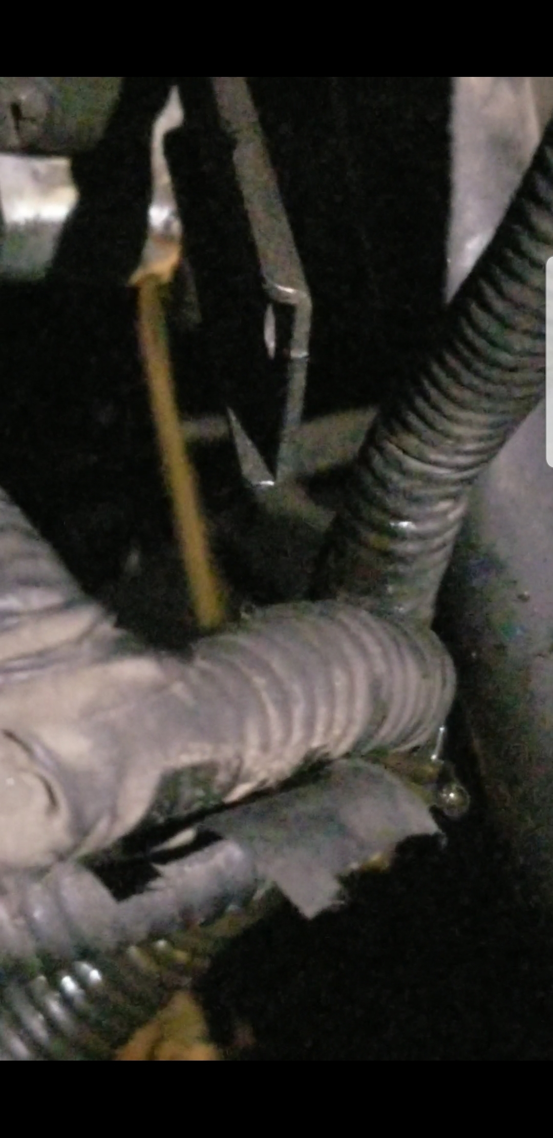

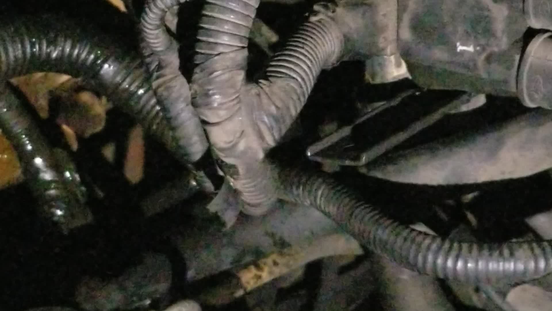

Brown coolant, not from radiator, seems to be leaking from under air intake. Not leaking from hoses, but from the metal part connecting the hoses. Put in stop leak, but seems to not work, yet. Hole is very small, about size of a toothpick.

Is there any way you can take a picture of the problem and upload it to the site for us please?

Hi. I've been trying to but seems not to be uploading. I have a video of the problem. I'll try again.
Thursday, January 9th, 2020 AT 4:23 AM
IANA MARMOLEJO
  • 5 POSTS
This is a picture.
Thursday, January 9th, 2020 AT 4:25 AM
IANA MARMOLEJO
  • 5 POSTS
Video.
Thursday, January 9th, 2020 AT 4:26 AM
SCGRANTURISMO
  • 4,897 POSTS
Hello again,

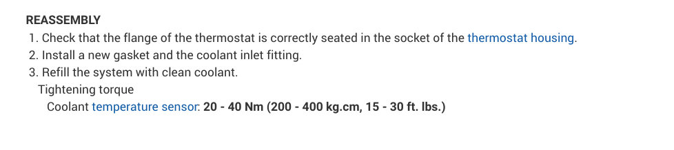

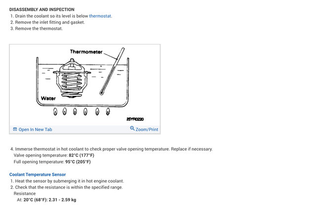

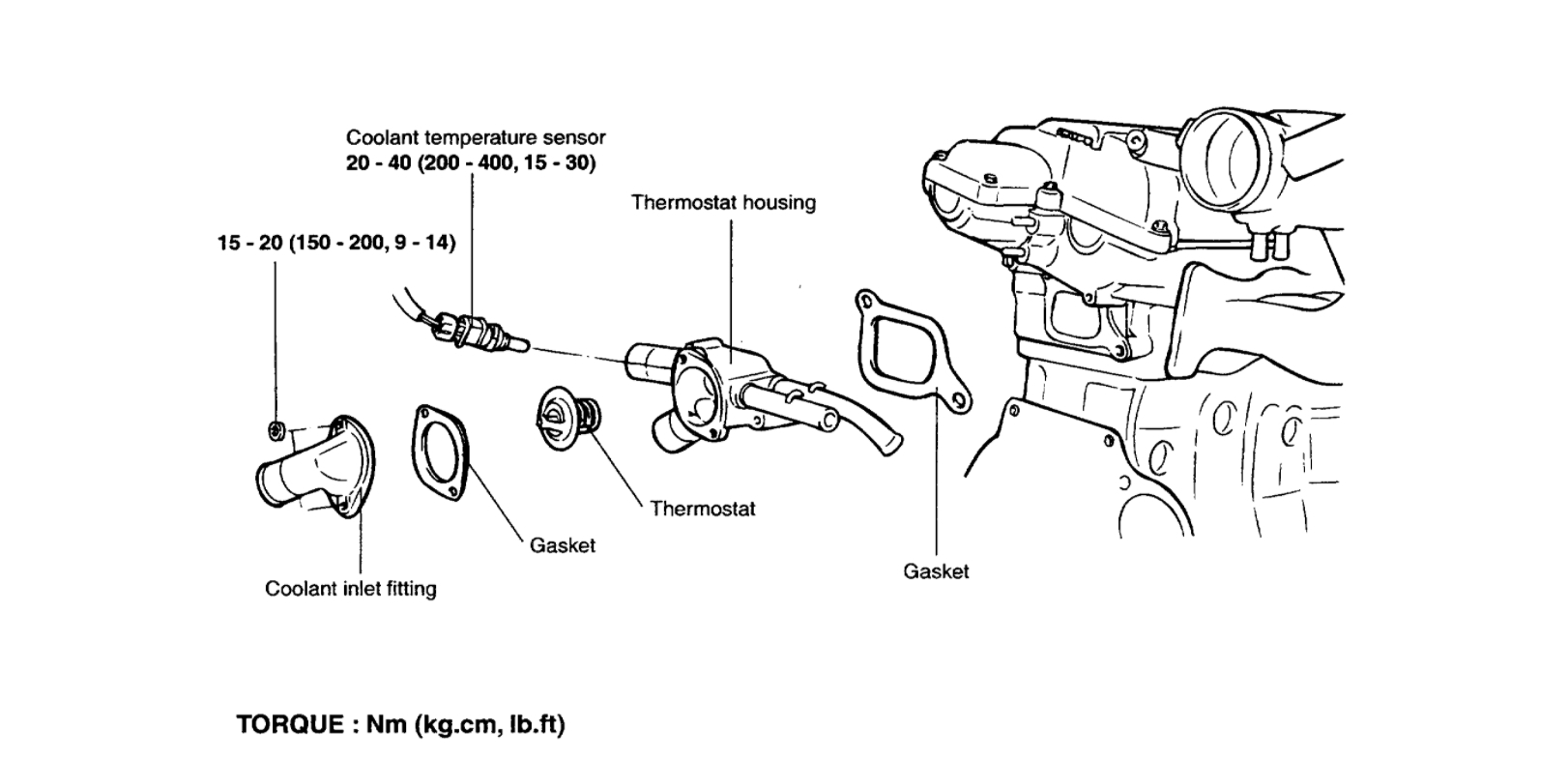

Okay, this looks like your thermostat housing gasket has failed. In the diagrams down below I have included the instructions for the removal and installation of your vehicle's thermostat, which you will want to change anyway since you are going to be there anyway. Please go through this guide and get back to us with how everything turns out please.
