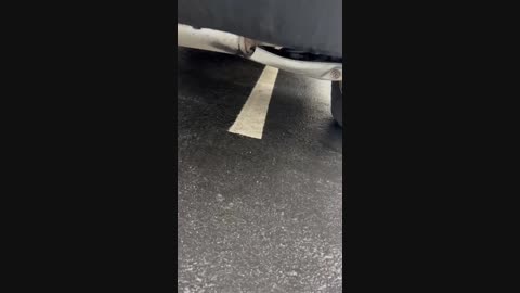

Only when the car is running it is leaking clear liquid out of the back of the bottom part of the car. I have a video to send.

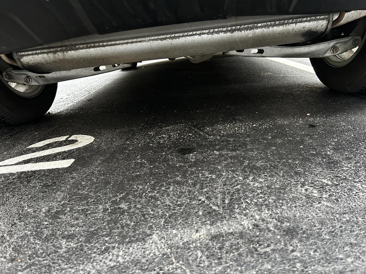

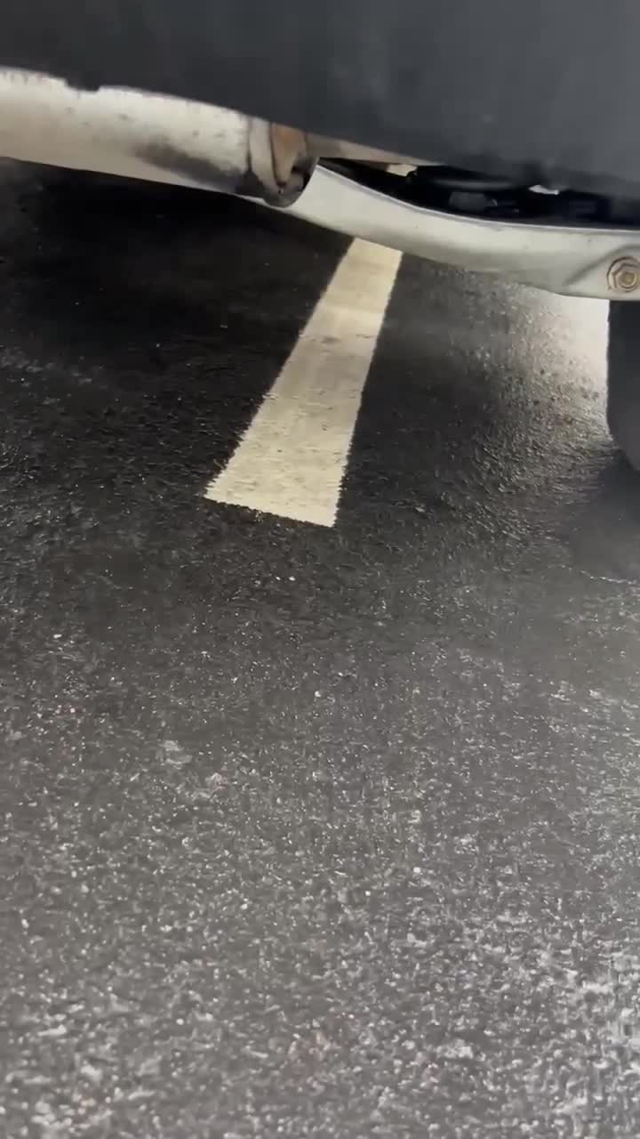

EKJB424
I will add the video below as well as a picture of the whole unit that seems to be leaking. Thank you so much that was very detailed and explained things. I am hoping that it is just condensed water vapor like you described. Please let me know what you think after seeing the video and pictures attached.

Dandy video. That looks like the bottom of the muffler. When the engine is running properly, the byproducts of clean combustion are carbon dioxide and water vapor. With the muffler way at the back, the water vapor has a lot of time to condense by the time it gets there. My suspicion is you won't see that dripping right after a rather long run at highway speed, but if you do, there's still nothing to worry about.
