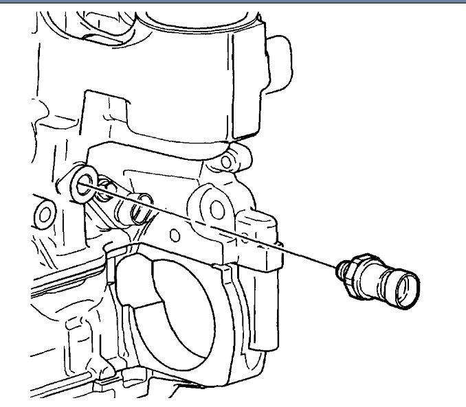

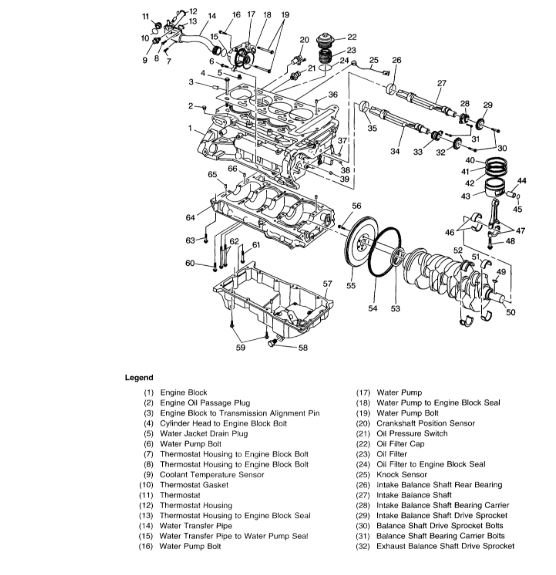

Where is oil pressure sending unit switch located?

Hello my name is Dave.
I have attached an illustration showing the oil switch. Hope it helps and thanks for using 2CarPros!

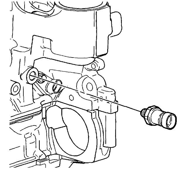

Good morning,
It is at the back of the block on the side of the motor next to the crank sensor.
I attached a picture for you to view.
Image (Click to make bigger)

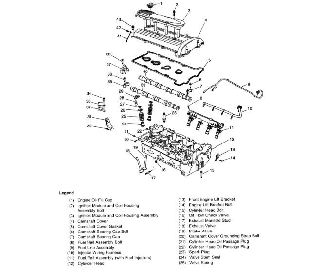

Thank you Dave! I wish I could have seen more of the motor surrounding that image!

Need to see more of motor surrounding that image!

If you give me a particular component you are searching for, let me know and I can post some pictures.

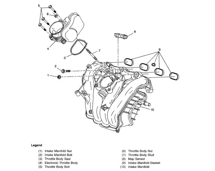

Any component that will show much more image surrounding oil pressure switch.

Some more pictures for you.
Images (Click to make bigger)
