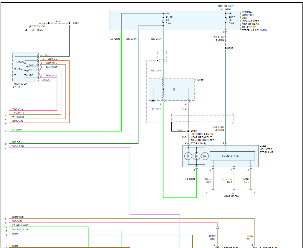

LCM wiring diagram?
2004 FORD CROWN VICTORIA
258,340 MILES • 4.6L • V8 • 2WD • AUTOMATIC
BEMORE DAWSUN

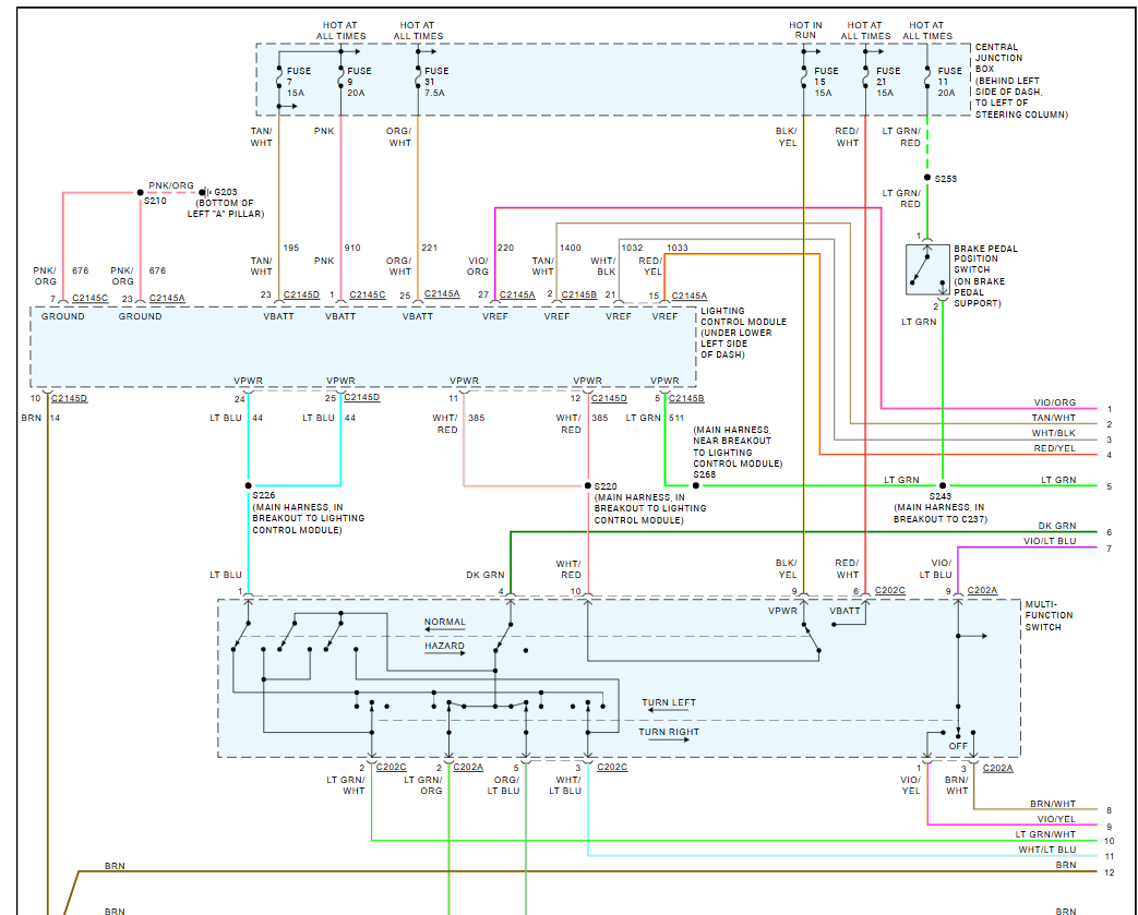

LCM is bad. I need to run a jumper wire from an accessory to the taillight wire, preferably by the LCM until my new one comes in.

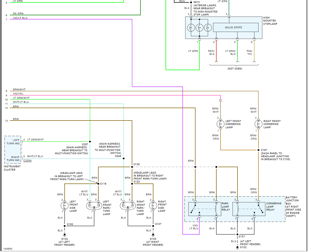

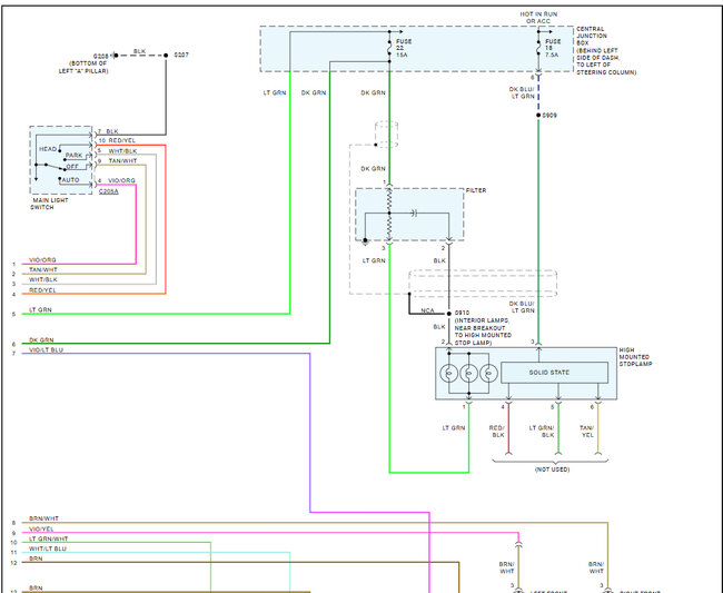

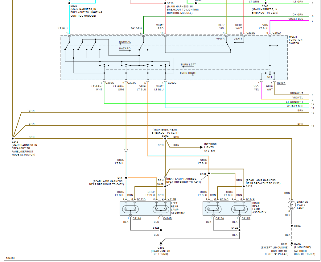

Good call, here is the lighting control module wiring diagrams so you can do the bypass. Check out the images (below). Let us know if you need anything else.
