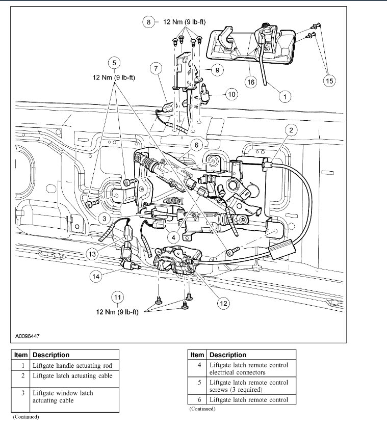

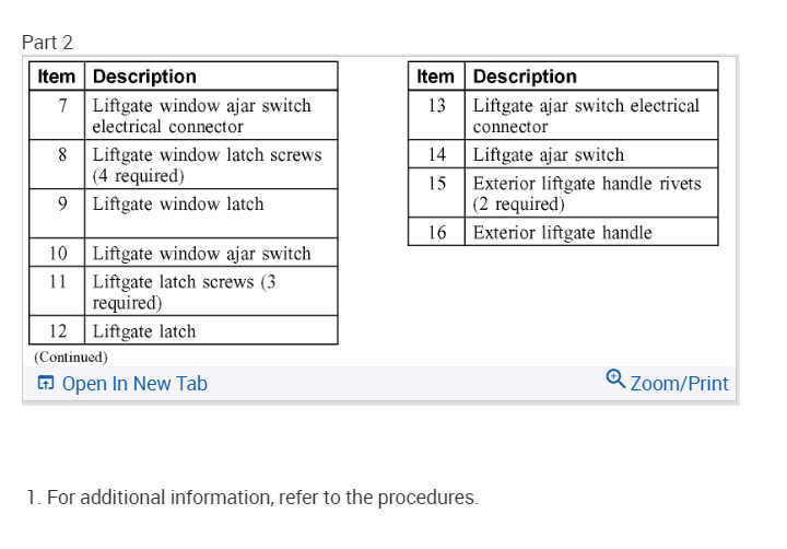

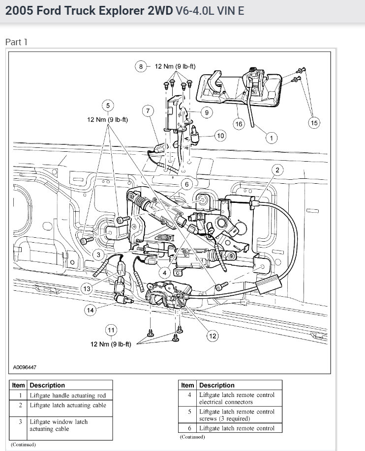

This can be because the latch is worn out or the striker needs to be adjusted outward. If the latch does not "close" completely it will pop open. You should hear the latch "click" when completely closed. If so and the liftgate still pops open the latch is bad and needs to be replaced here are the instructions to do so in the diagrams below.
LIFTGATE LATCH
Removal and Installation
1. Remove the liftgate trim panel.
2. Position the water shield aside.
3. Disconnect the liftgate latch actuating cable.
4. Remove the 3 liftgate latch screws.
- To install, tighten to 12 Nm (9 lb-ft).
5. Disconnect the liftgate ajar switch electrical connector and remove the liftgate latch.
6. To install, reverse the removal procedure.
- Lubricate the liftgate latch after installation.
Check out the images (below). Let us know what happens and please upload pictures or videos of the problem.

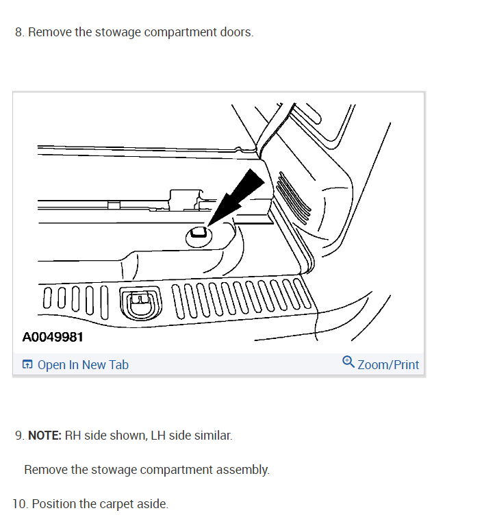

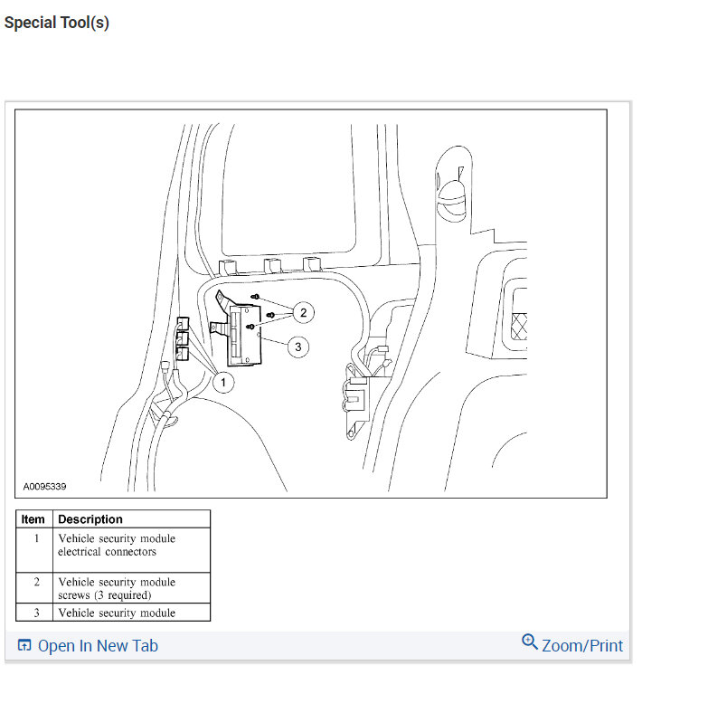

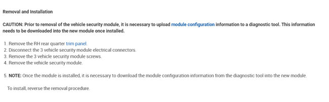

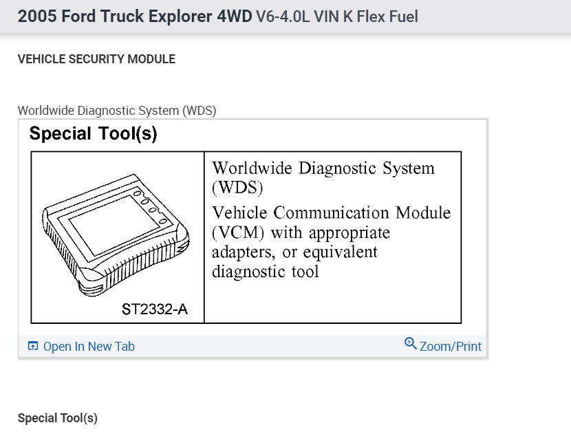

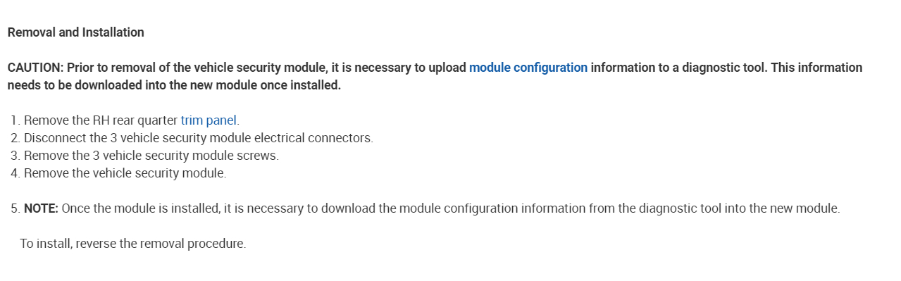

Sure, no problem, that is the liftgate window or rear window. This happens when the vehicle security module goes out here is the location and instructions on how to change it out. Please let us know what happens.

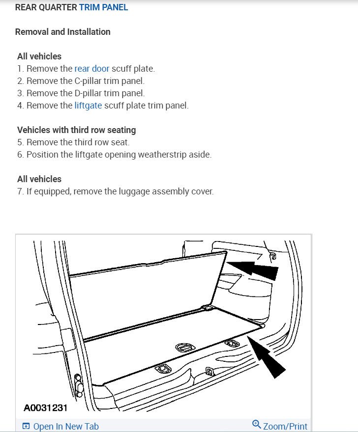

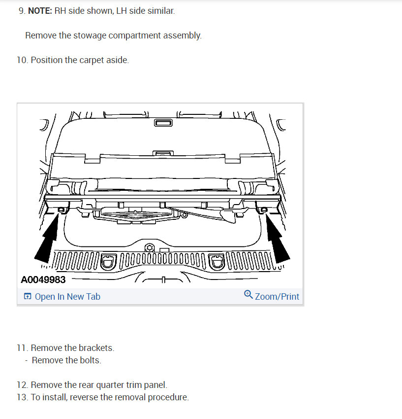

The frequency of the liftgate opening by itself has been much less. It seems it got less immediately following replacing the battery which was always going low. I would like to get to the suspect security module but honestly, I don't know where to start to remove the panels it is behind. Are there and instructions for doing that? I really don't want to make it look bad.
Thanks,
Tom

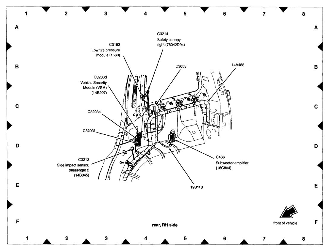

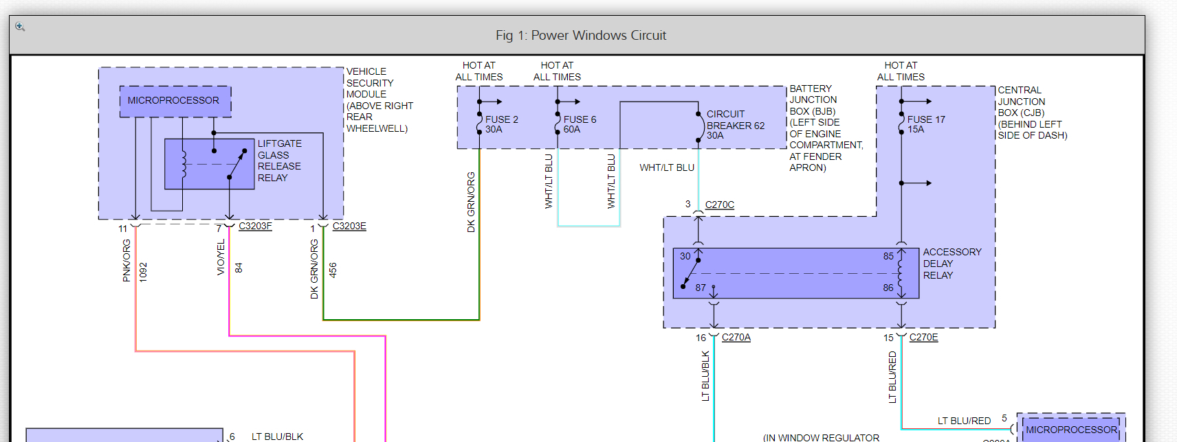

Good call on the security module here is the wiring to show you the control relay for the rear window is controlled by it, you should be able to get a rebuilt, preprogrammed unit by searching google or eBay. The module is located in the right rear quarter panel. Check out the images (below). Please let us know what happens.

The sensor is in the latch of the liftgate. Please check out the images below to see what I am talking about. Check out the images (below). Please let us know what happens.
