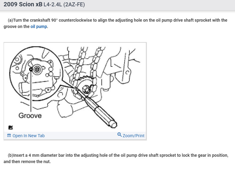

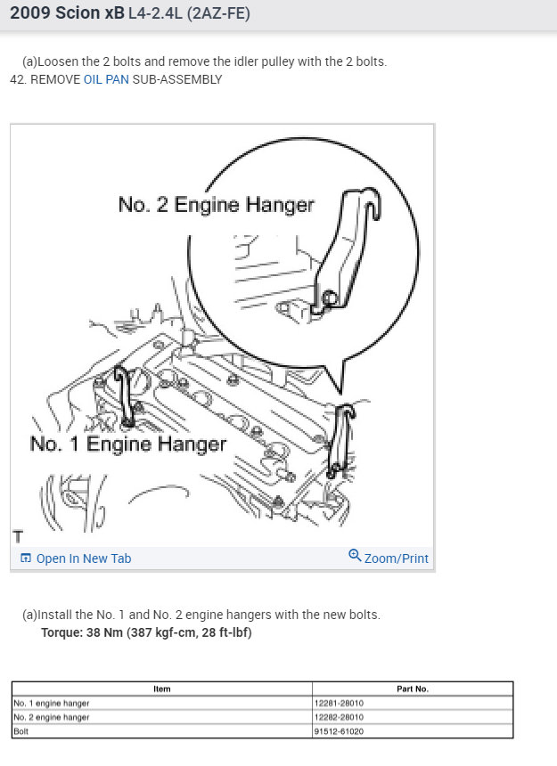

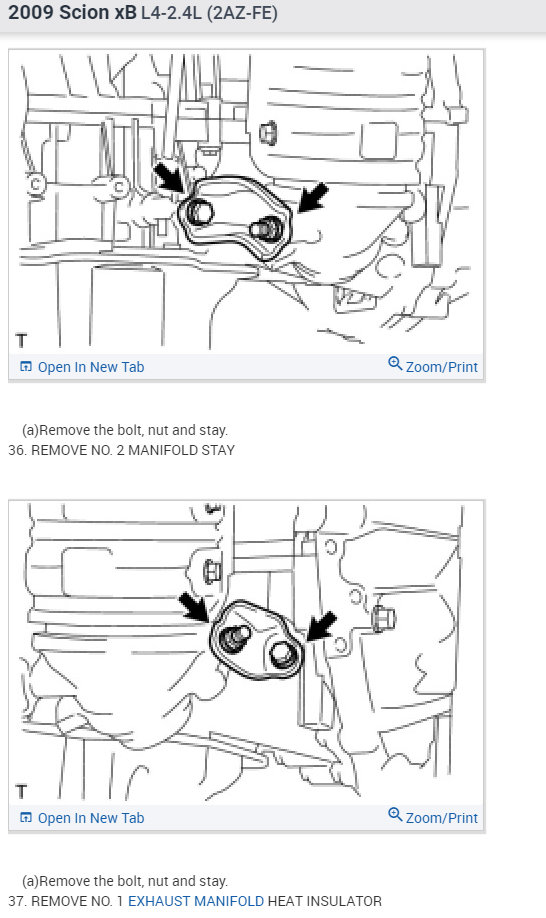

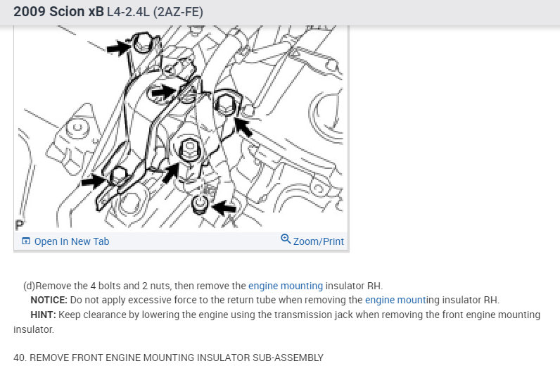

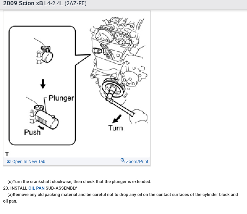

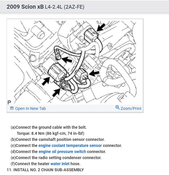

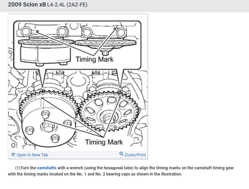

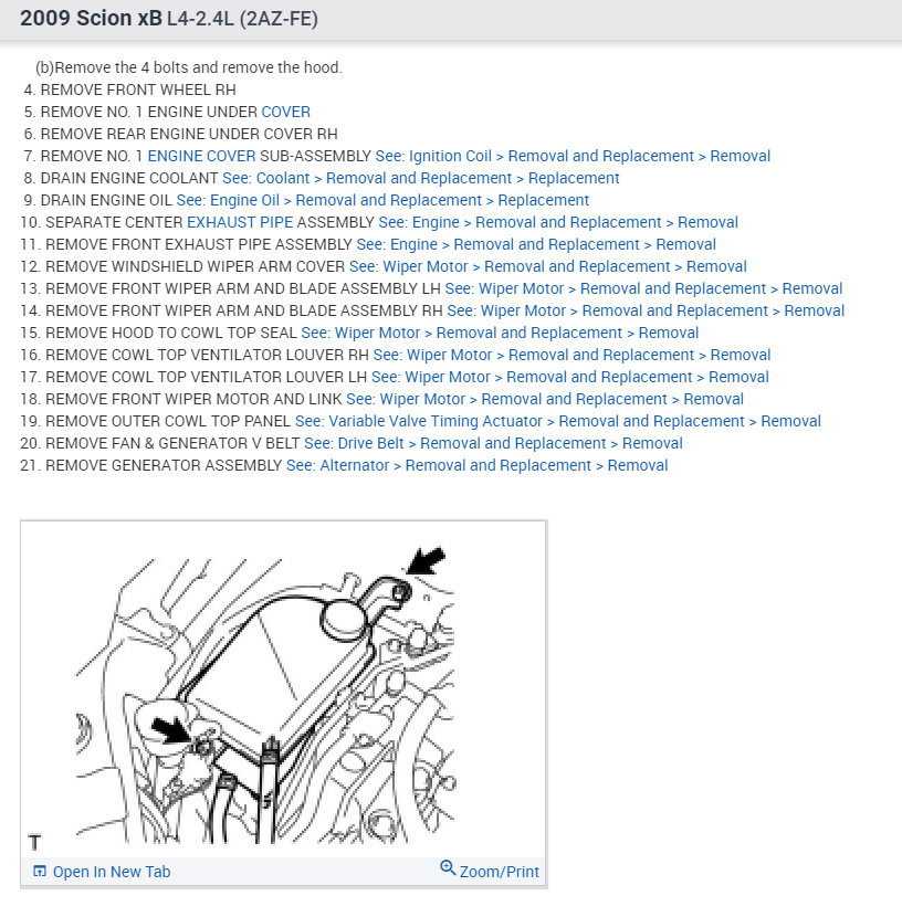

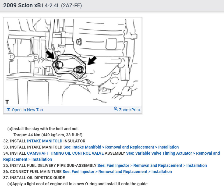

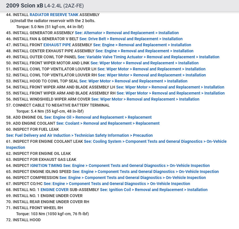

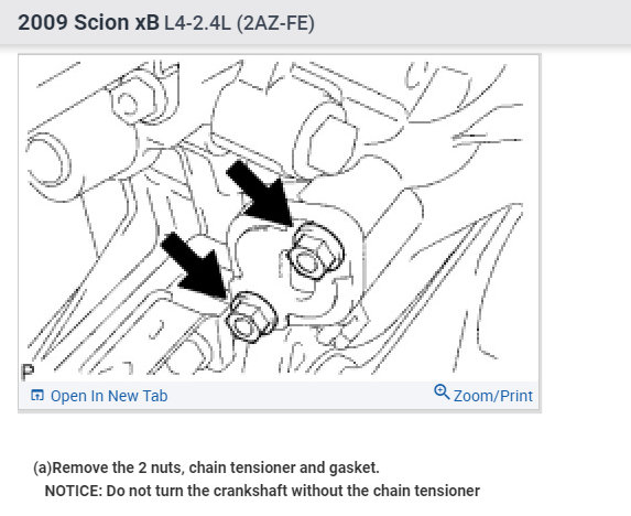

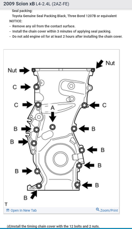

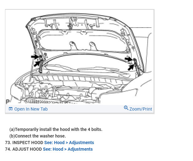

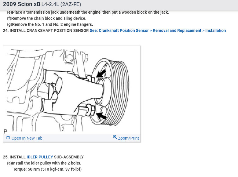

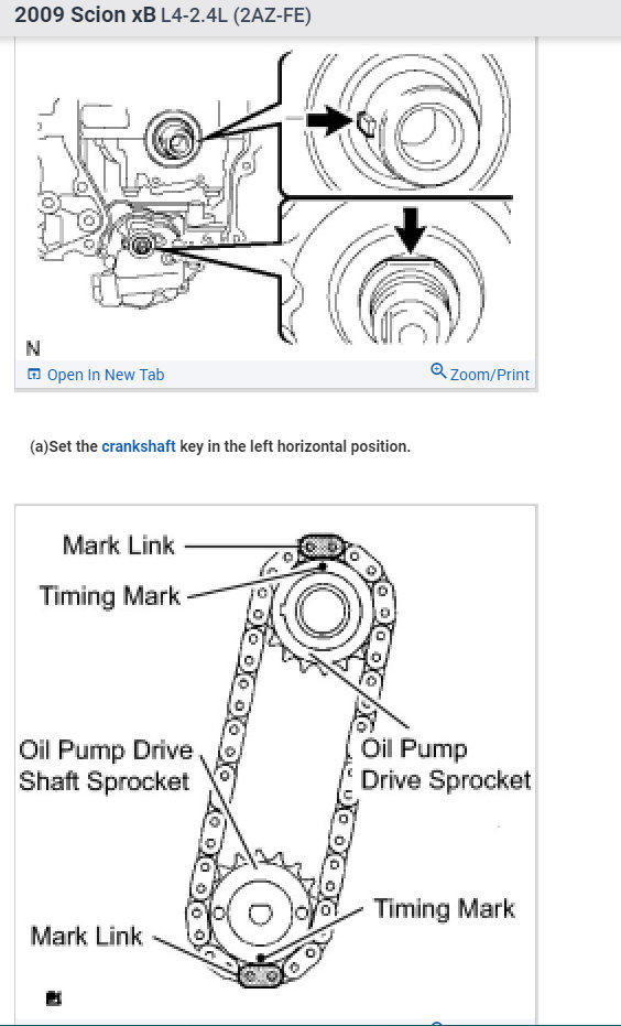

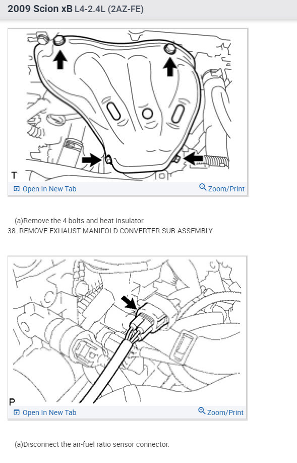

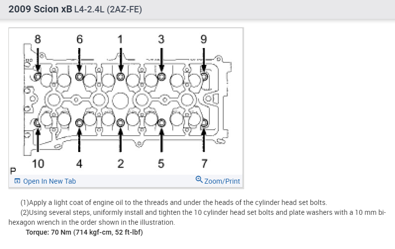

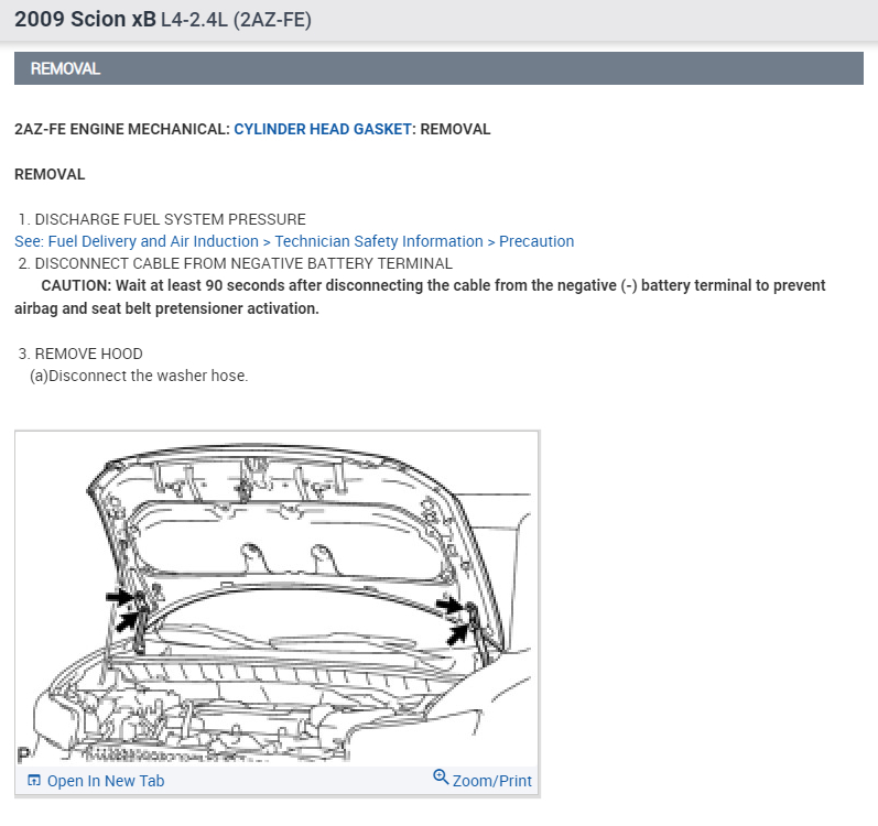

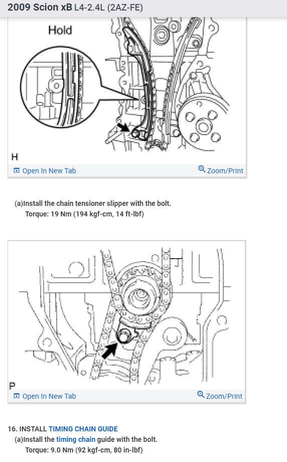

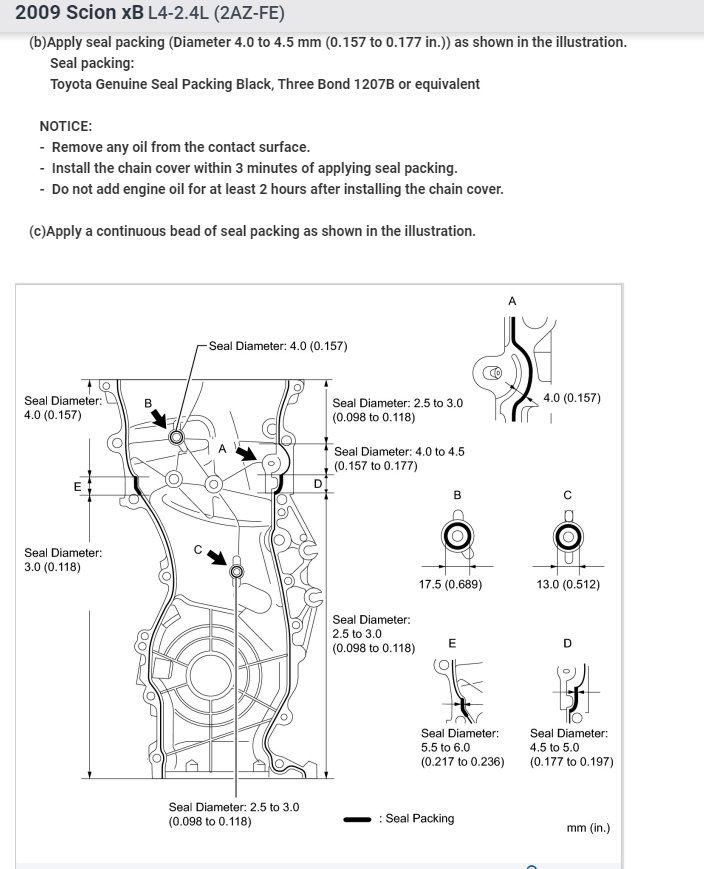

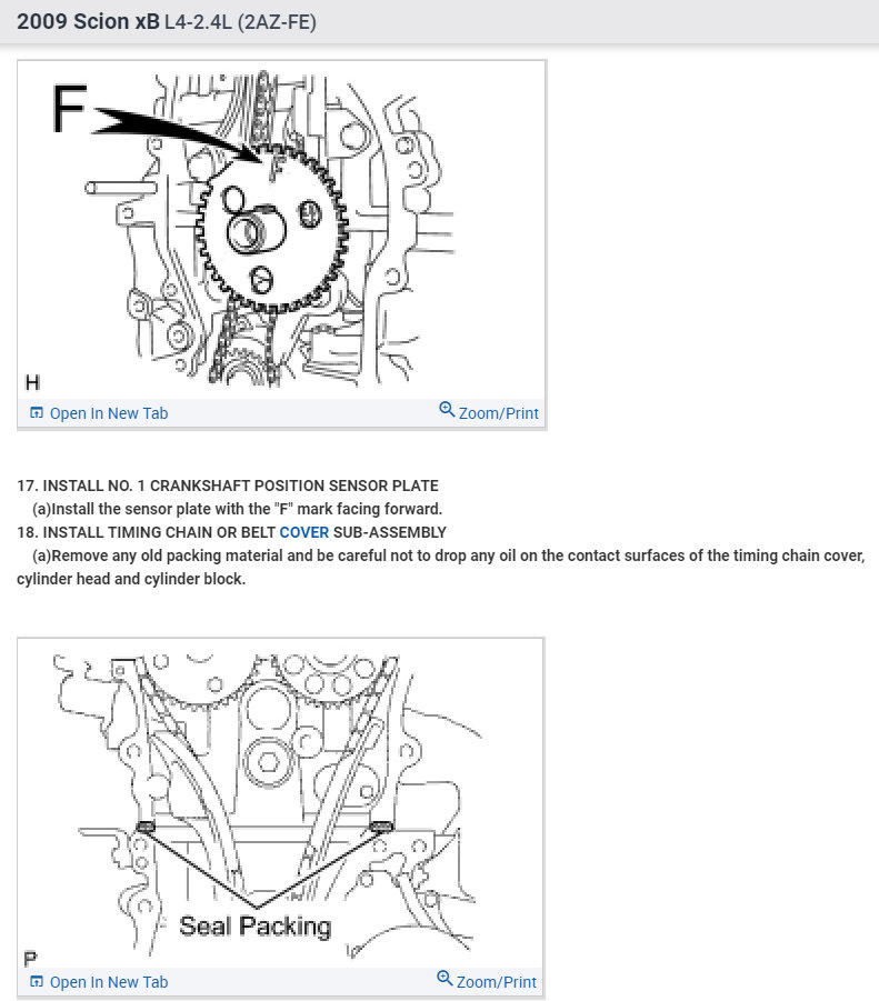

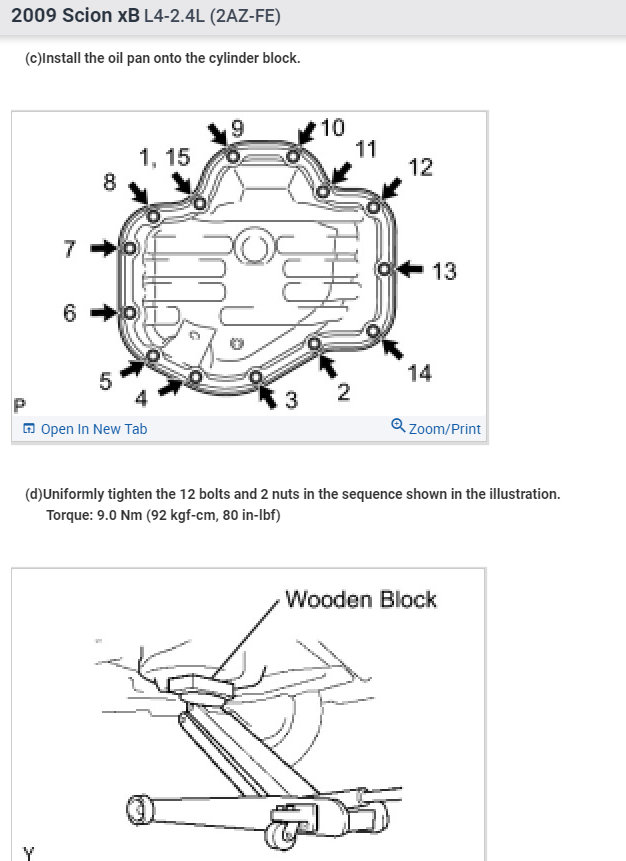

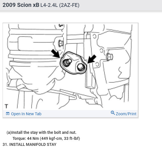

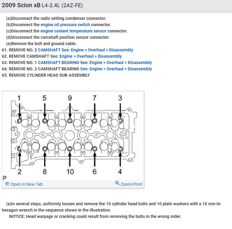

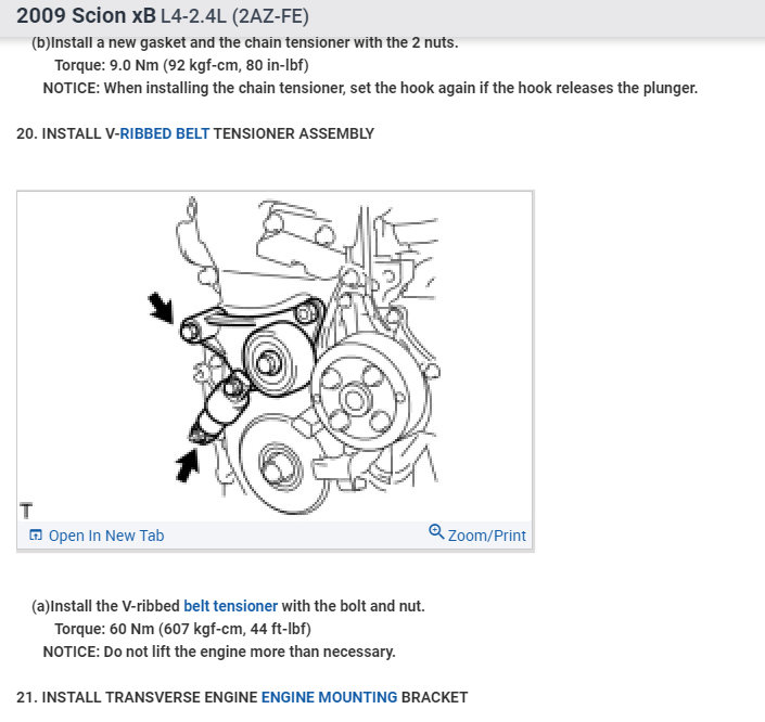

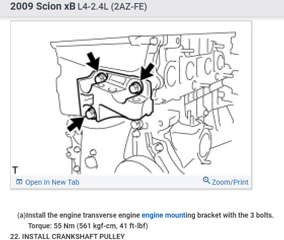

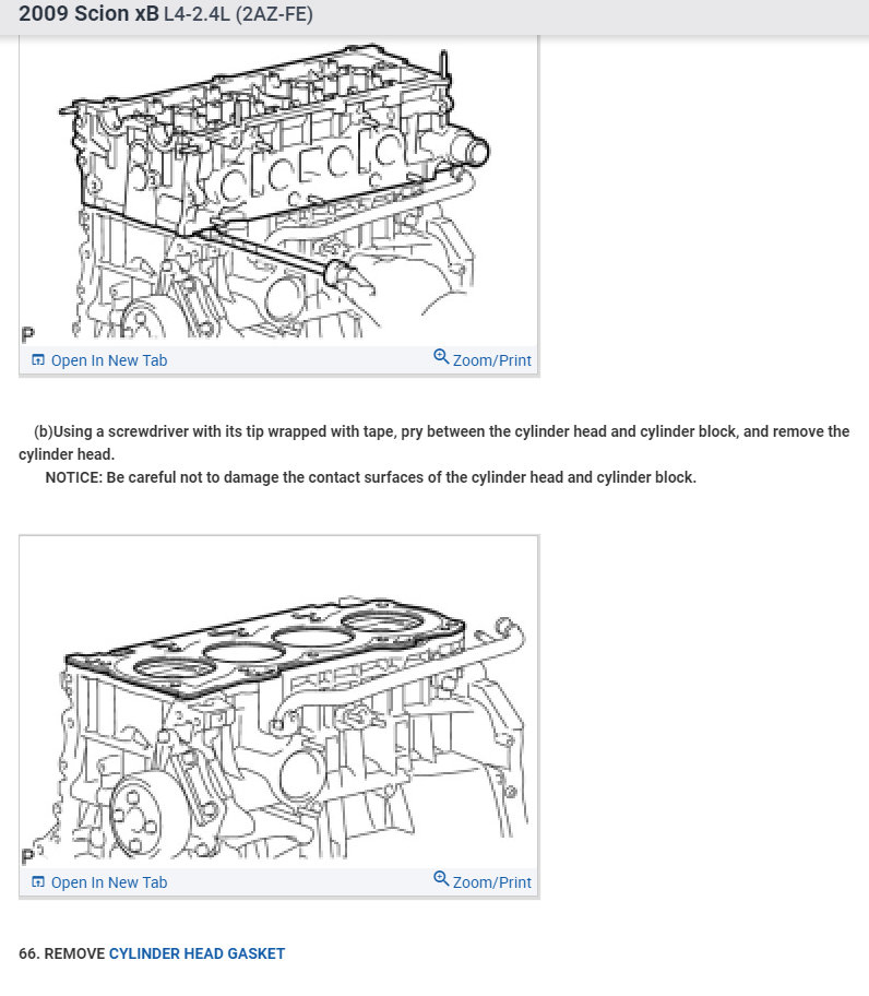

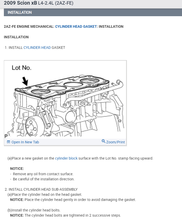

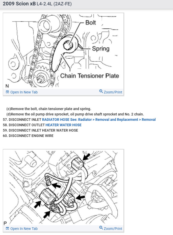

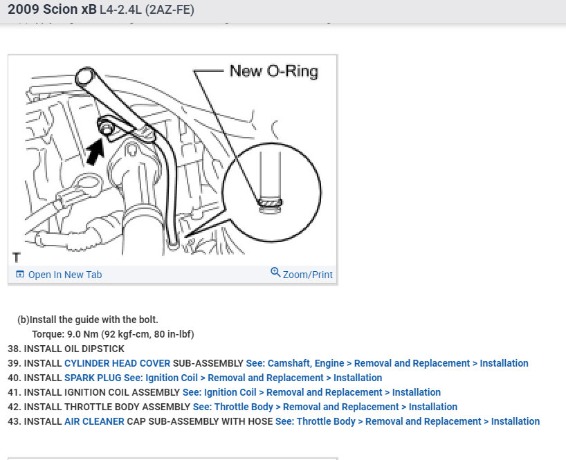

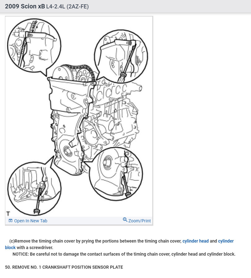

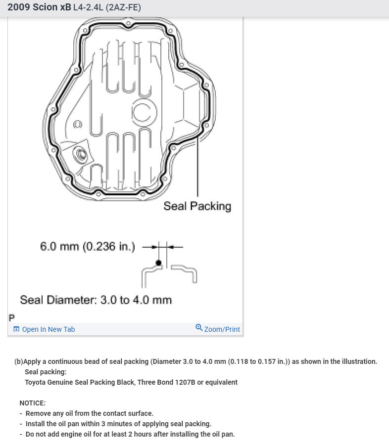

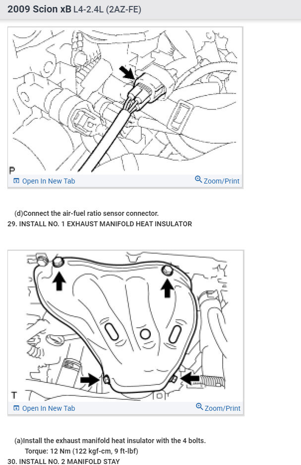

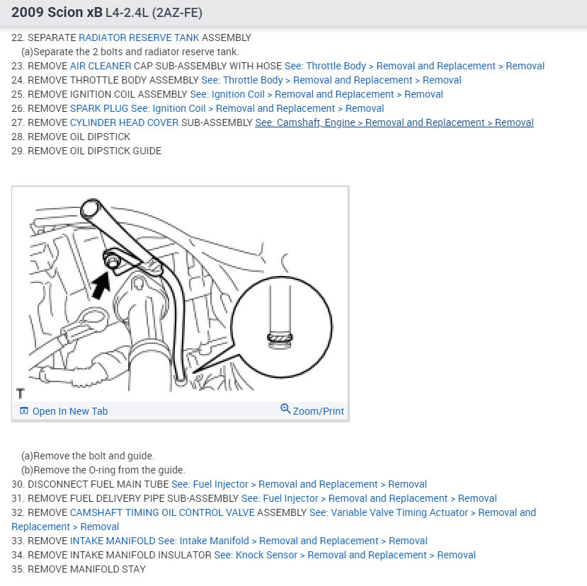

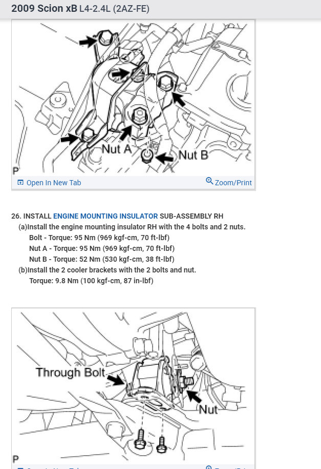

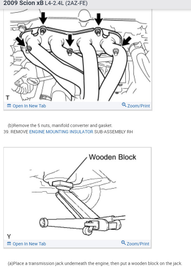

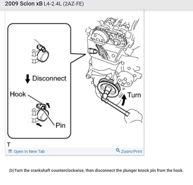

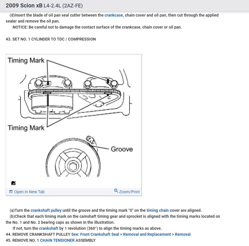

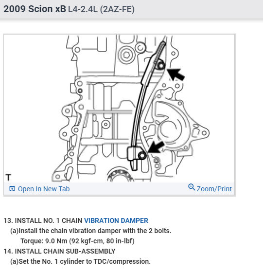

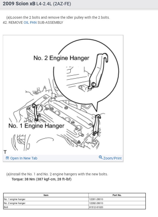

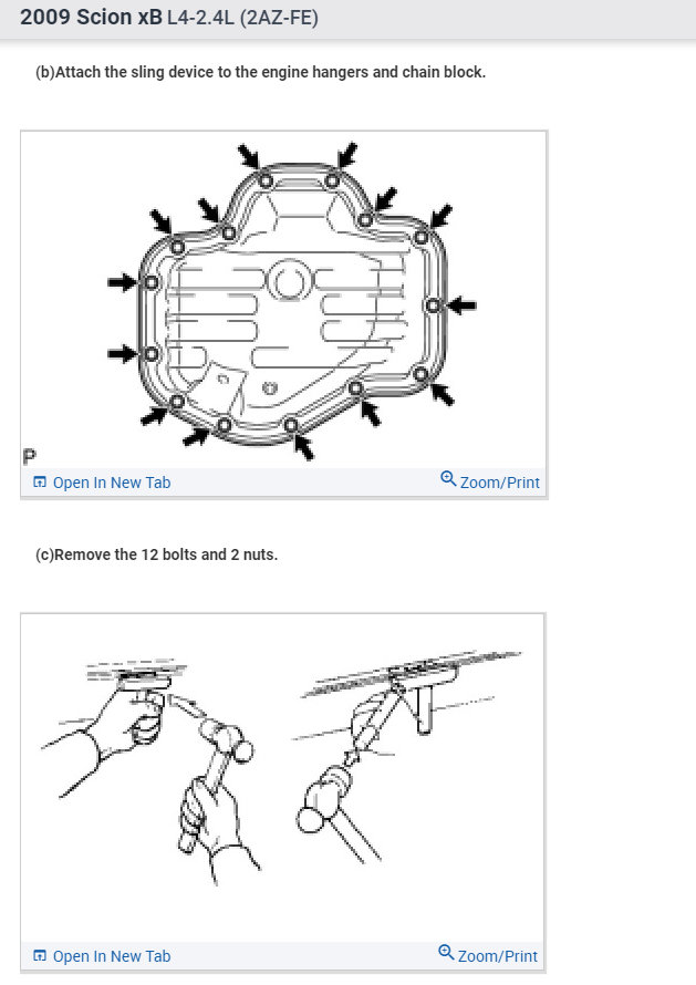

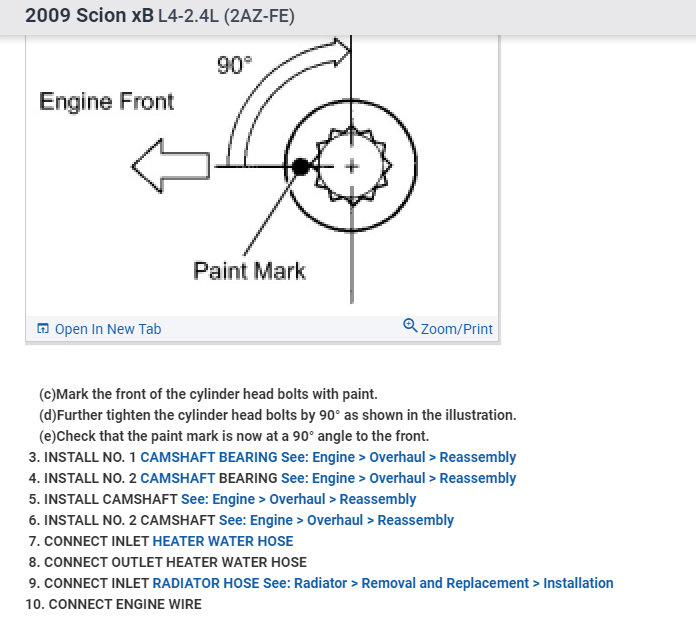

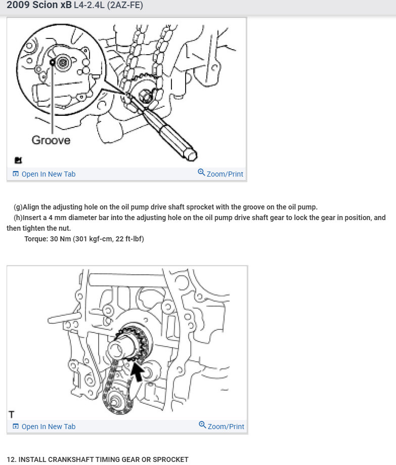

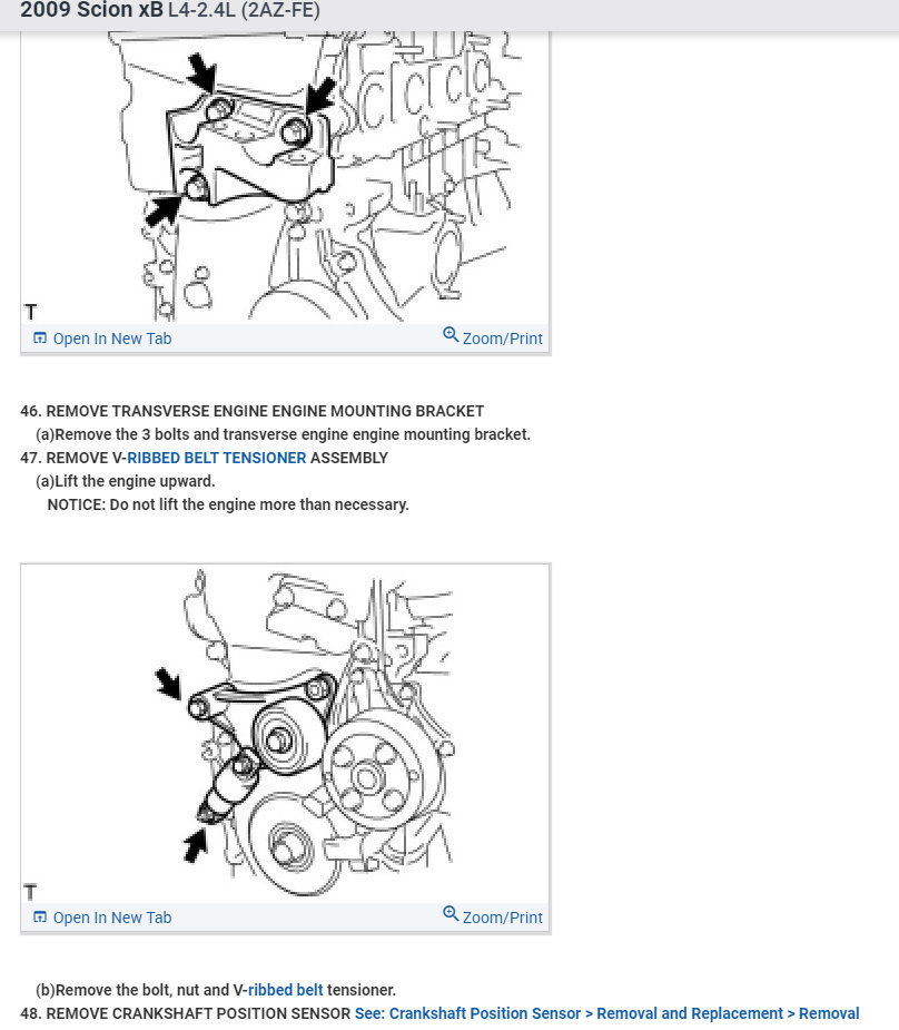

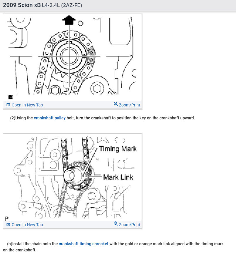

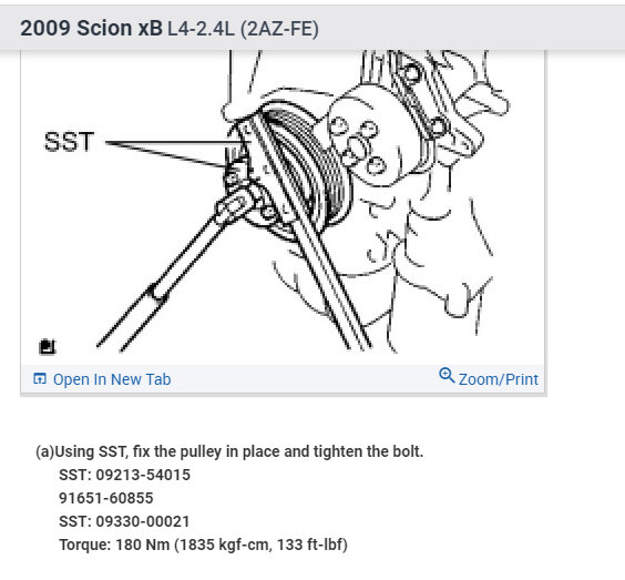

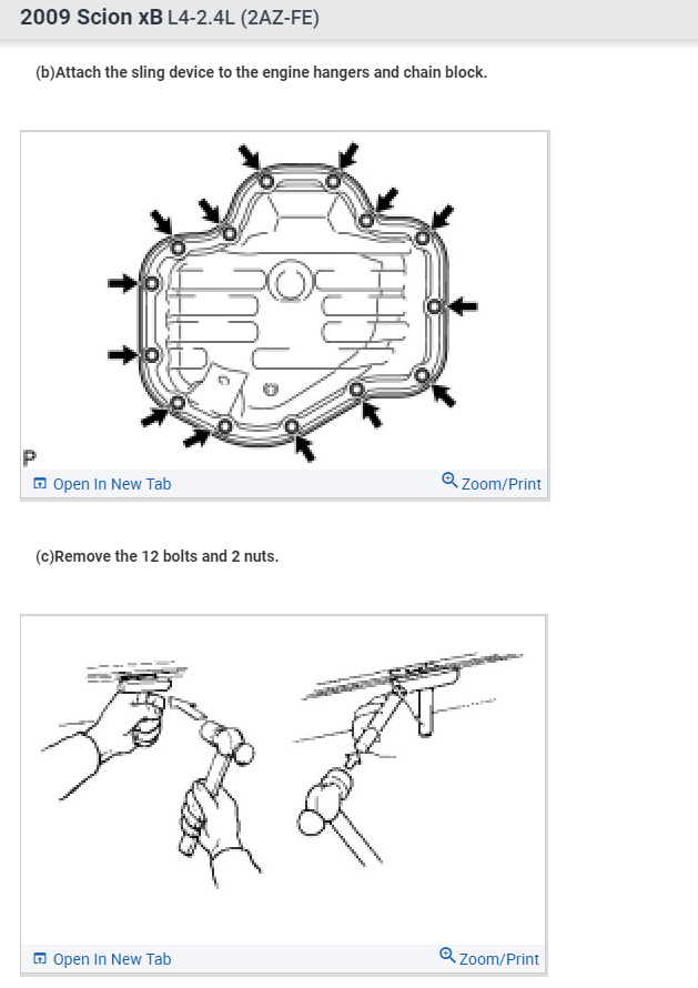

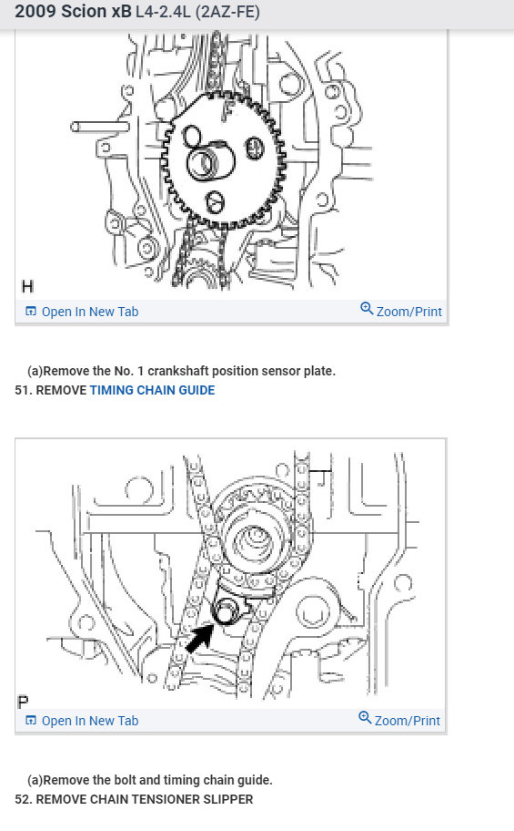

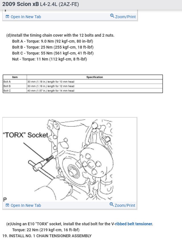

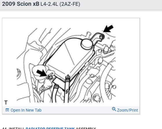

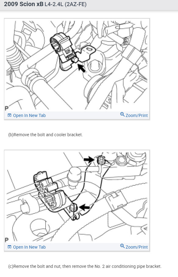

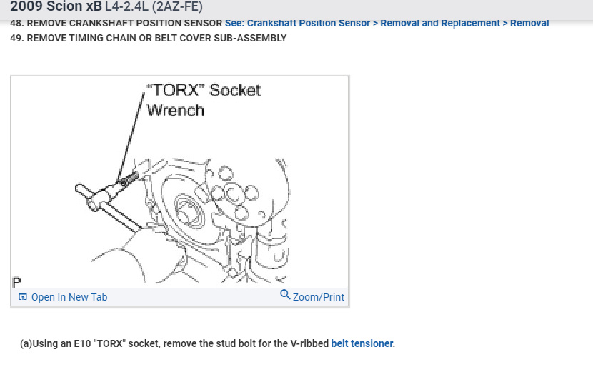

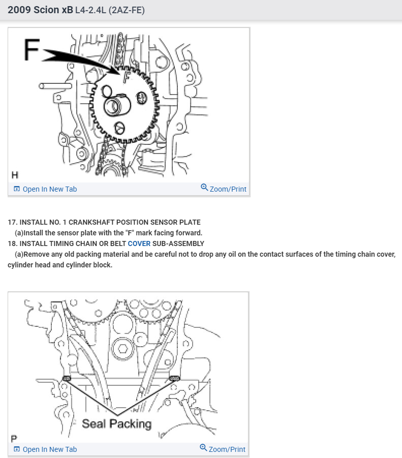

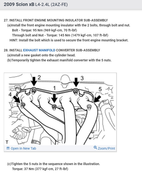

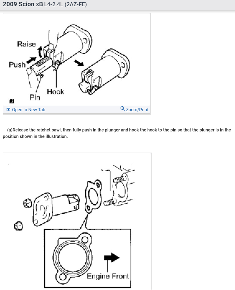

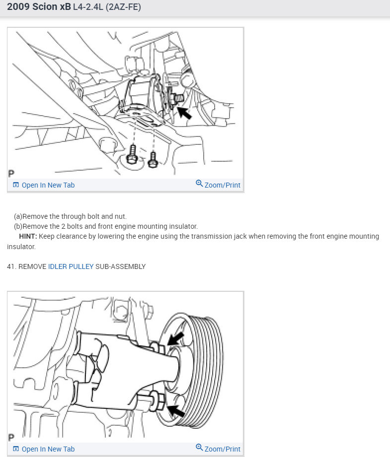

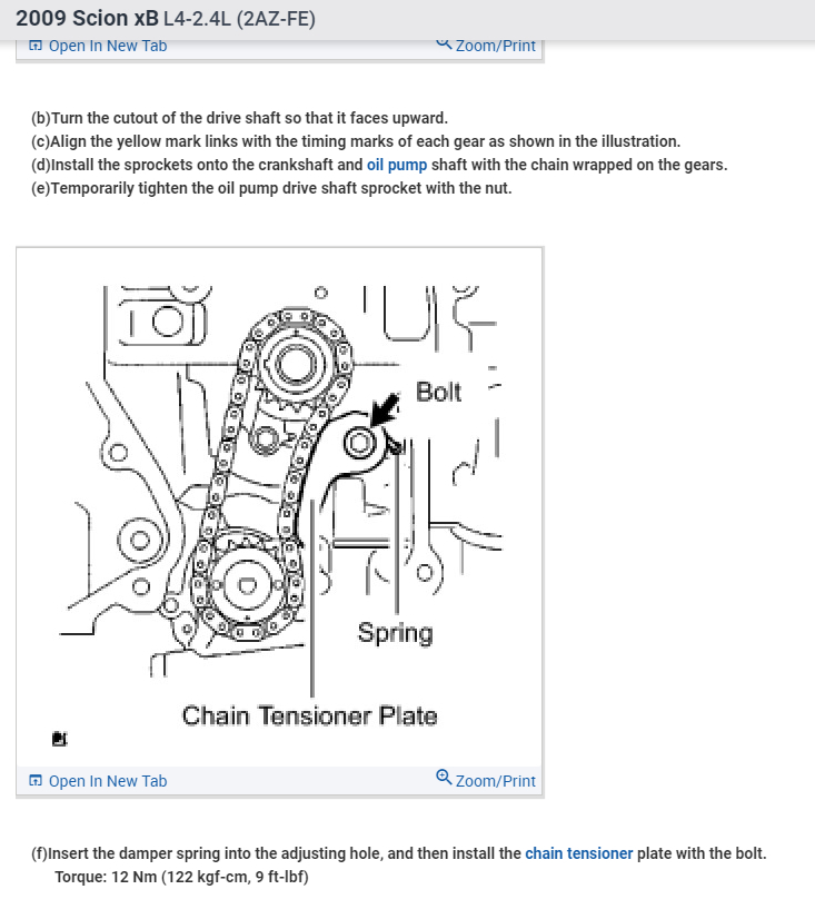

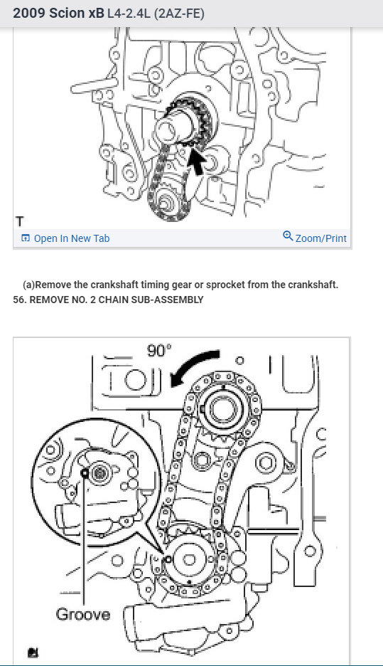

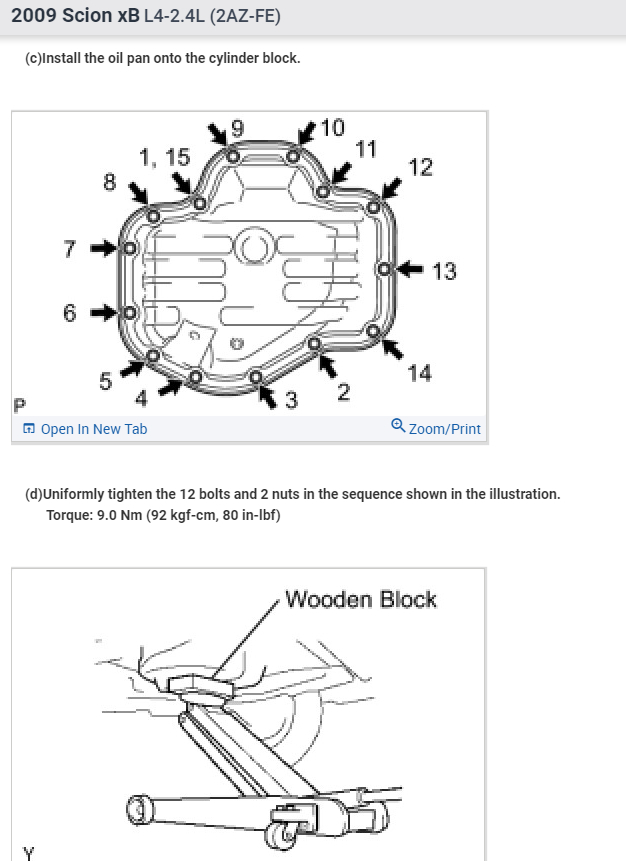

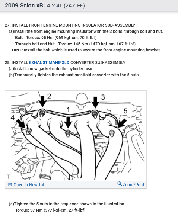

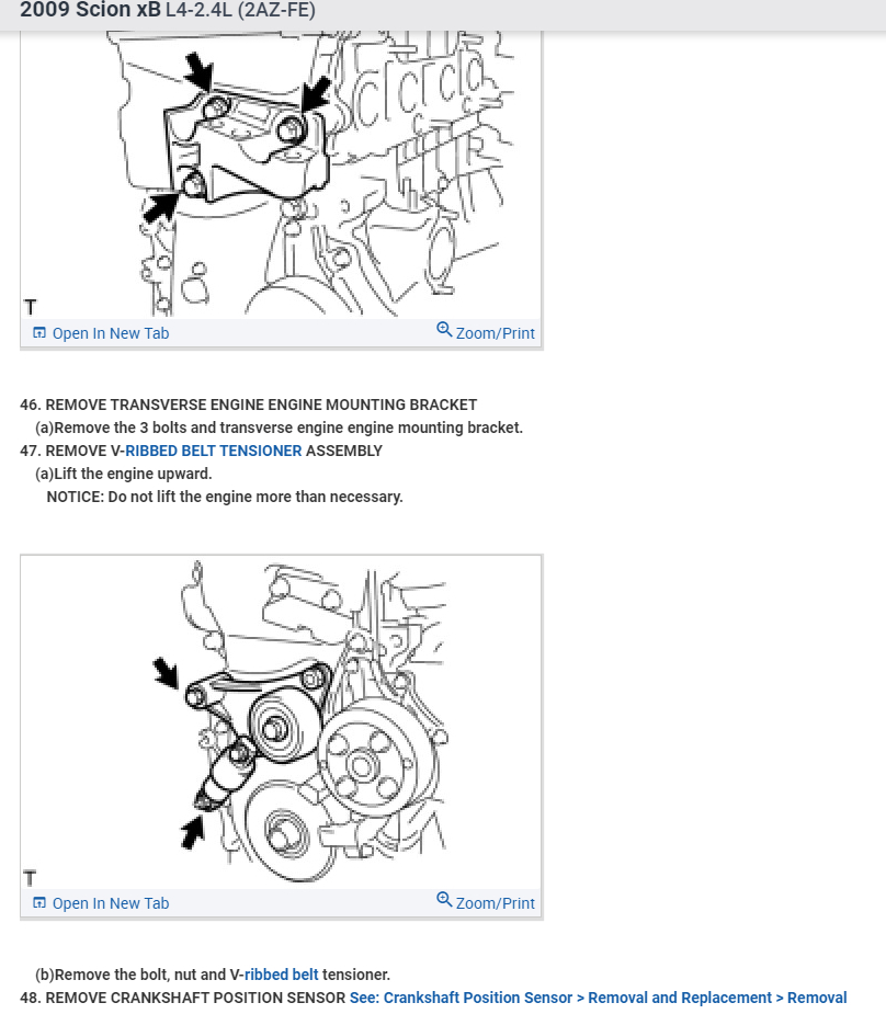

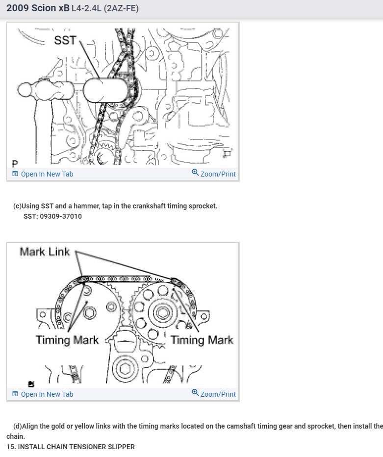

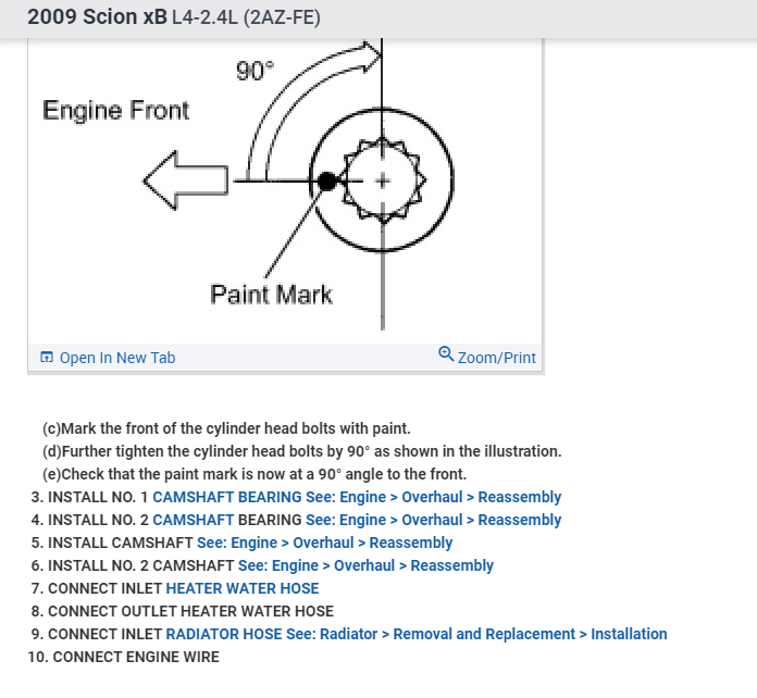

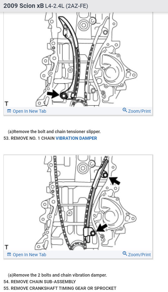

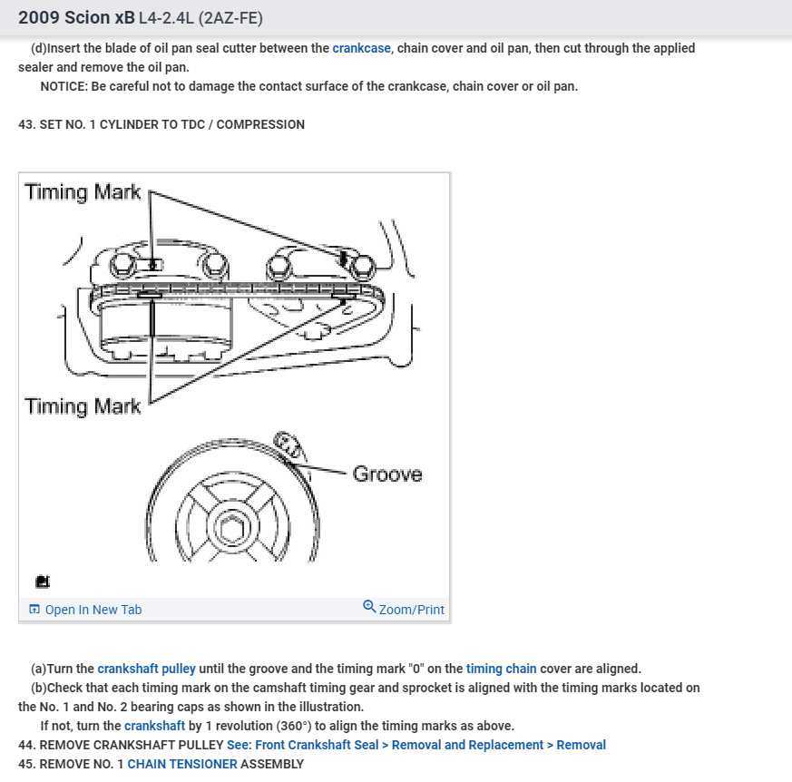

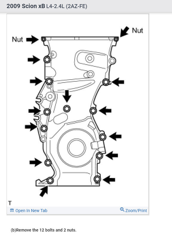

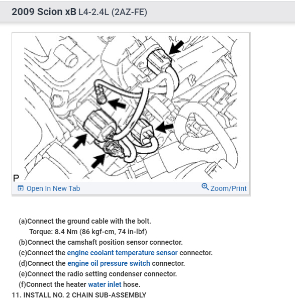

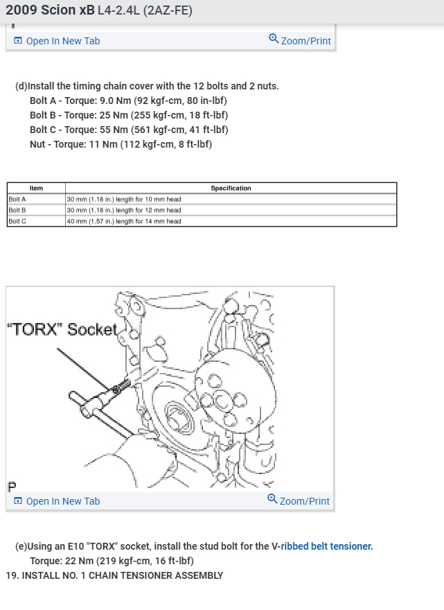

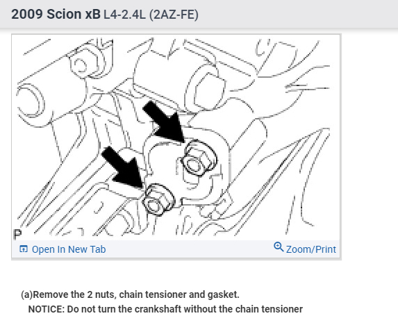

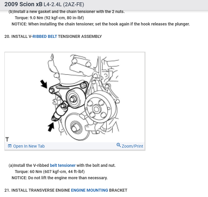

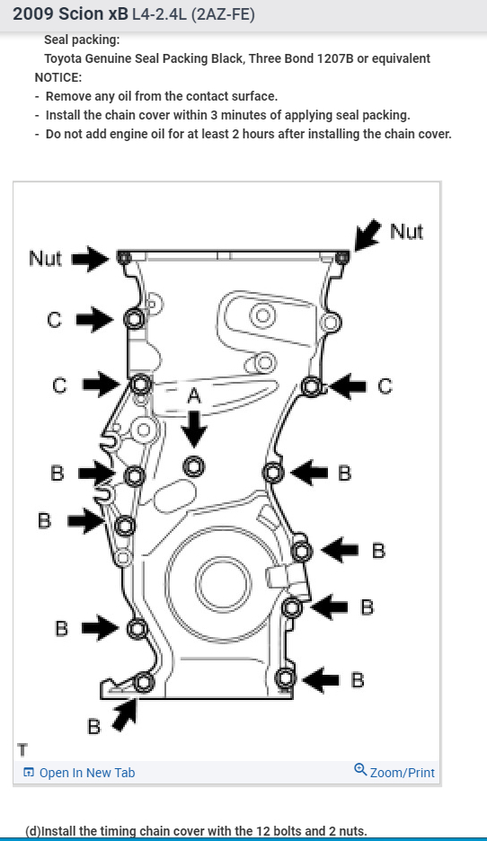

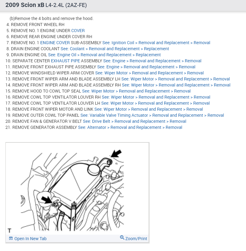

The head gasket and timing kit calls for 12.1 hours.
Depending on your comfort level it could take longer than the book hour.
I have attached the procedure below for your reference.
