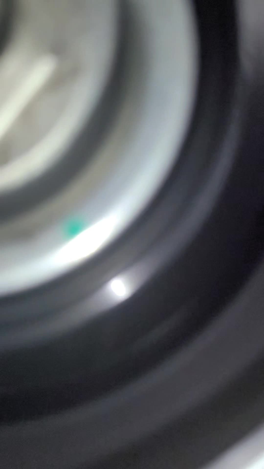

Lol. I apologize. You never know these days. So, my next step is the alternator pulley. I can turn the pulley both ways with a flat head inserted. I read that it should only turn in one direction. Also, it makes noise and moves somewhat when I spin it manually. Thats literally the last pulley I haven't replaced. I don't suspect the alternator because I have no issues with starting the car, no lights flicker, etc. Thoughts? Also, could it just be a lose belt (which I just put a new one in but not OE).
Saturday, November 18th, 2023 AT 10:39 PM
  • 110,192 POSTS
The alternator can turn in either direction. However, keep in mind, although it is charging, the bearing still could be faulty.
The idea that you have replaced everything, like you, I suspect the alternator must be it.
Let me know if that resolves the issue. I just had an idea. Remove the alternator and have it bench tested at a parts store. They actually put a belt on it and spin the alternator. Hopefully, that will tell you if that is the issue. It's just a thought, but it may help.
