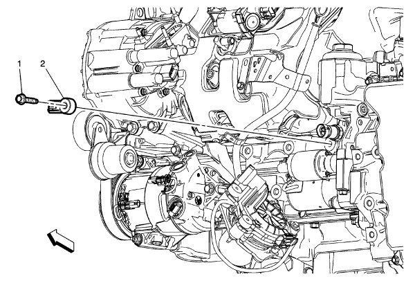

location for the knock sensors on the car listed above.
Jan 10, 2018 at 5:31 PM
HARRY P
  • CAR REPAIR CONTRIBUTOR
  • 2,292 POSTS
This is what ALLData has on the 2.4L Hybrid Malibu knock sensor. The non-hybrid options are 2.0 and 2.5, so let me know if this is the right one or not.

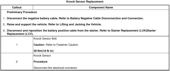

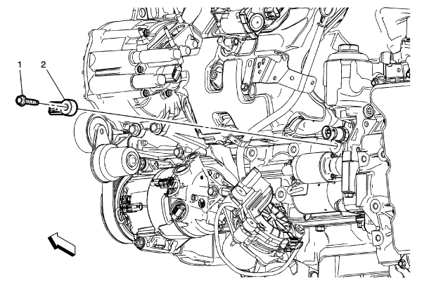

MHPAUTOS
  • 31,937 POSTS
See picture. item 5 should be the same other side of engine. Check out the diagrams (Below). Please let us know if you need anything else to get the problem fixed.

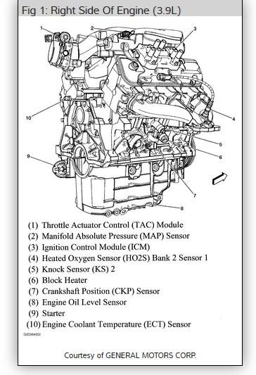

14GREENEYES75
Where is the engine knock detonation sensor located on my Chevy Malibu 99. Thank u for your time and help.
Sep 7, 2020 at 2:10 PM (Merged)
WRENCHTECH
  • 20,761 POSTS
It's on the left side of the block, near the transmission. https://www.2carpros.com/images/external/86422029.jpg.gif
it is on the front of the motor lower side by the oil filter. there are 2 sensors there. one is the oil pressure sensor and the other is the knock sensor.
