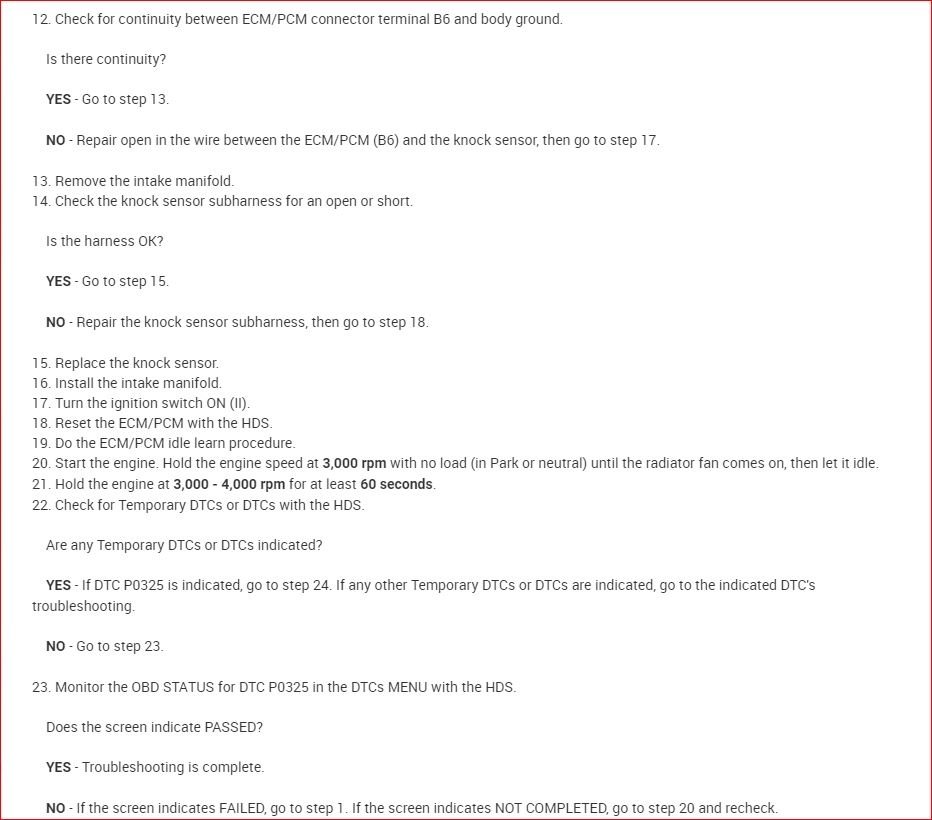

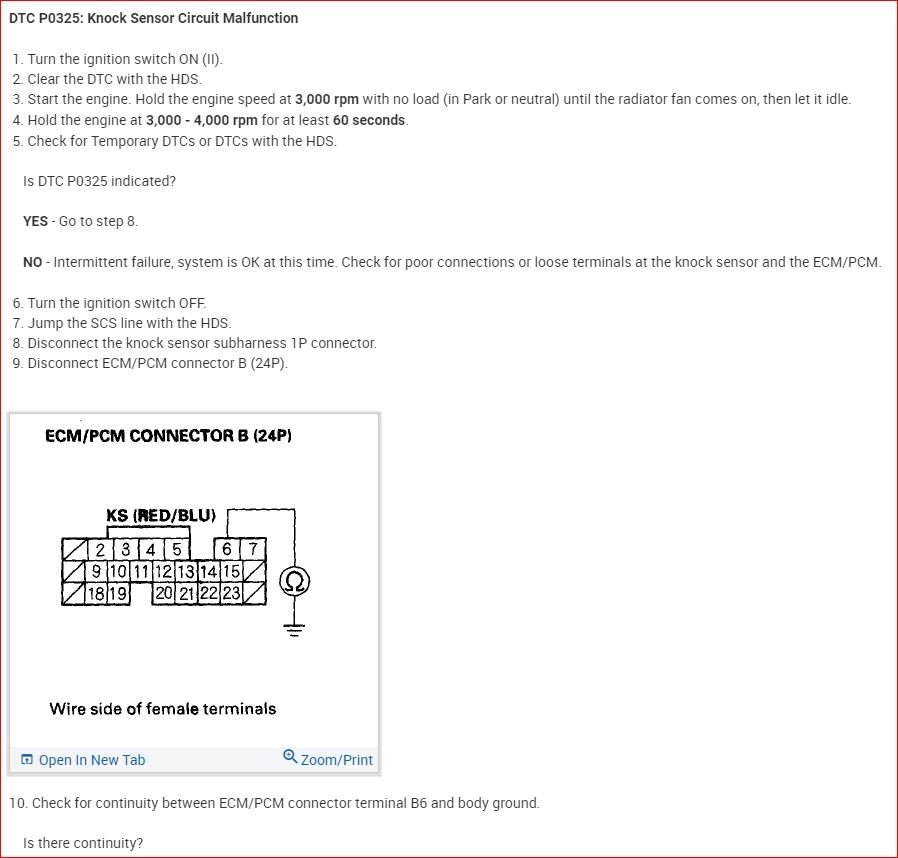

was replacing heater control valve middle firewall area , moved main harness out of way a bit , put everything back and took for a spin , P0325 knock sensor code
is there a diagram step by step replacement with torque specs etc.
also is there anything i should check before replacing the sensor ?
May 14, 2019 at 8:09 PM
  • CAR REPAIR CONTRIBUTOR

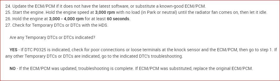

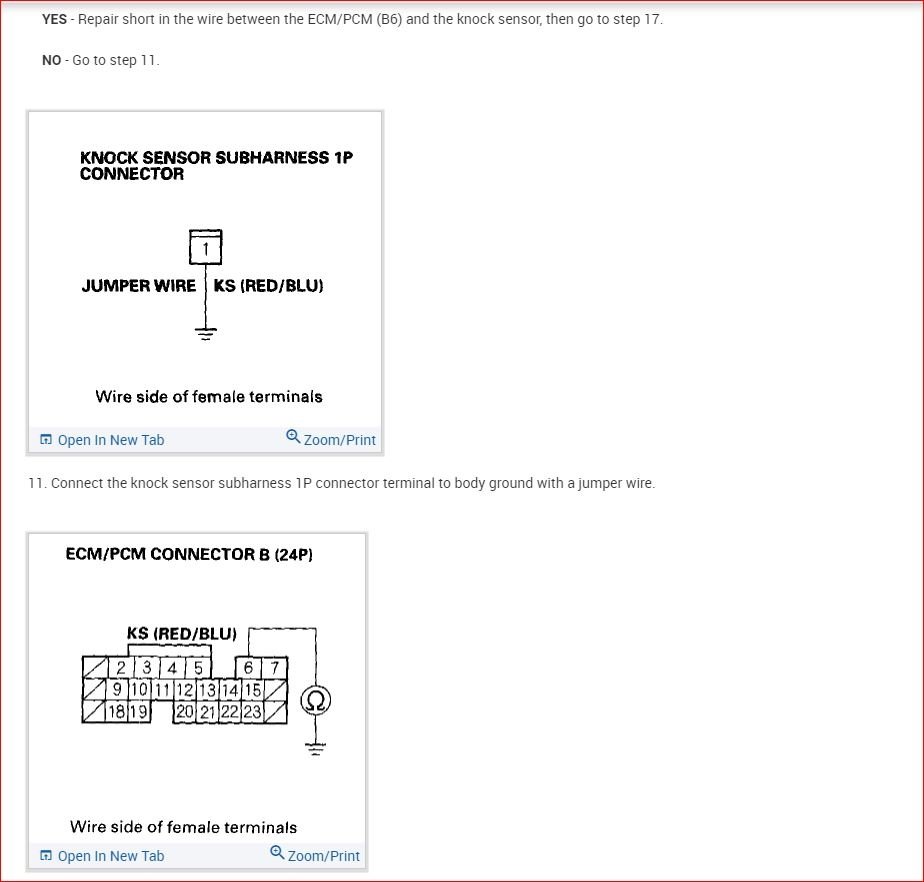

I attached the test procedure for this code. I would not just replace the sensor if all you did was move the harness. More than likely you just have a wiring issue or terminal issue in the connector. This test talks a lot about checking for continuity. This means do have a good wire or is there an open circuit. If you have a terminal issue in the connector, replacing the sensor will not fix it.
Further more, this DTC is for a circuit issue not necessarily a faulty sensor.
