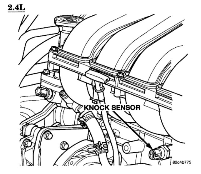

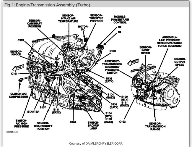

Where is the knock sensor located?
Wednesday, November 23rd, 2016 AT 9:46 AM
9 Replies
HMAC300
  • 48,601 POSTS
The knock sensor is on the side of the block. Check out the diagrams (Below). Please let us know if you need anything else to get the problem fixed.

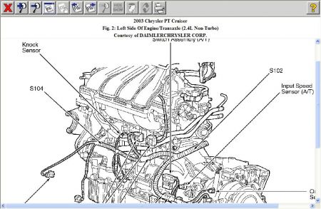

Service engine light came on. Took it to auto zone, knock sensor. Can you tell me where it is located?
+10
Tuesday, March 19th, 2019 AT 2:14 PM (Merged)
  • 75,992 POSTS
See below
https://www.2carpros.com/forum/automotive_pictures/12900_ks_4.jpg
+28

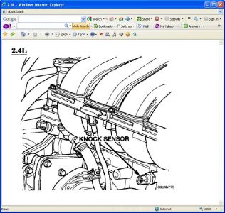

DESTNY
  • 2003 CHRYSLER PT CRUISER
Four cylinder front wheel drive automatic 82,000 miles.
Location of the knock sensor and diagram.
