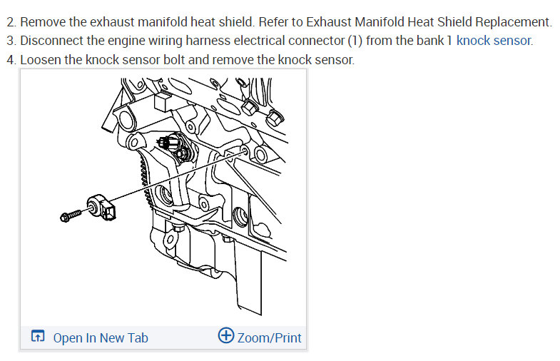

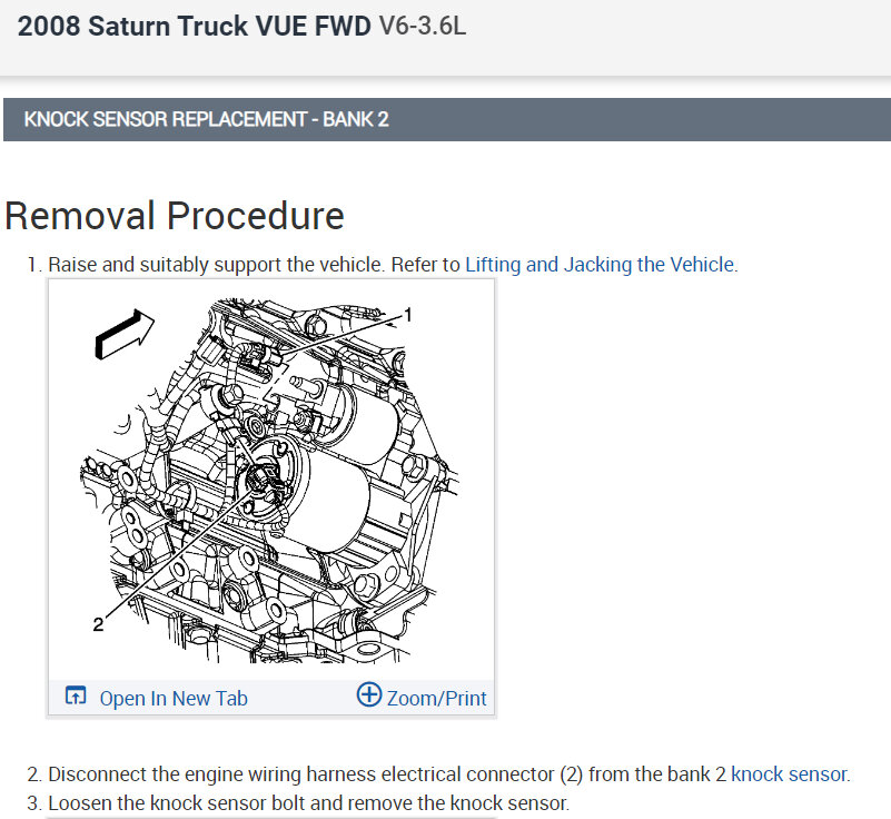

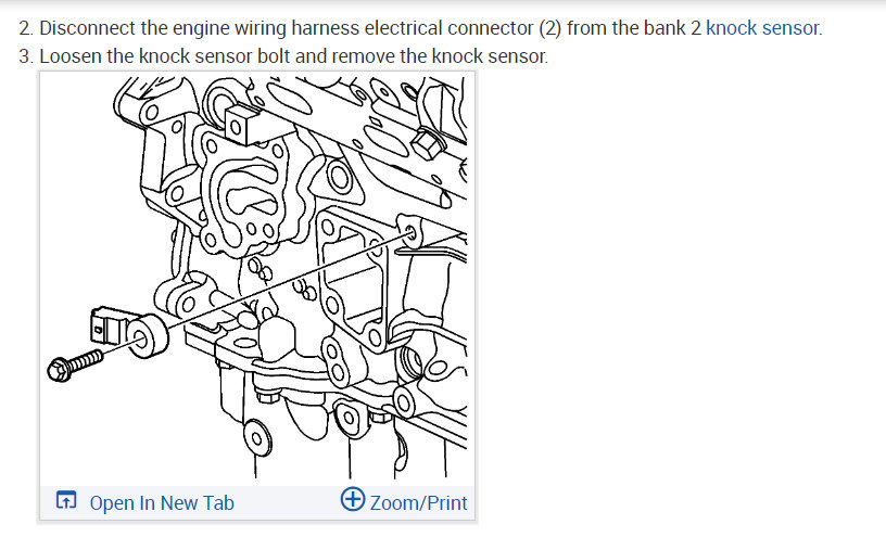

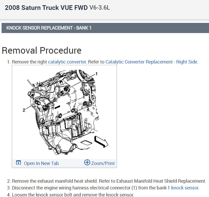

I have diagnostic code that reads P0330 First, I know there's (2) Knock Sensors for this year, with the code I gave, which Sensor is this, and where is this located? I like to replace, both Sensor, and connector harness. Would you possibly have the part numbers by any chance?
Thank you, I appreciate any info you can provide me with!

So, this engine has two knock sensors. Here are the locations for both:
The code P0330 on your 2008 Saturn Vue refers to a "Knock Sensor 2 Circuit Malfunction (Bank 2)."
The second sensor in the images below is the sensor bank 2. Check out the images (below). Please let us know what happens.
