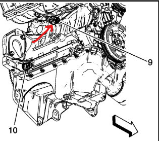

I have a check engine code for the knock sensor. Where is the knock sensor for replacement?

Screwed into the side of the engine block under the intake manifold good luck

Yep, MECHTRIX is correct, here is the location. Check out the images (below). Let us know how it goes.
