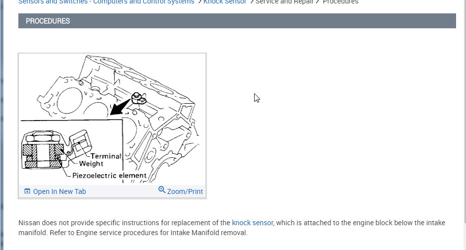

Cant find location of knock sensor and need instructions on how to replace it. It runs rough only while driving. It idles fine.I got a code 34.Please help.

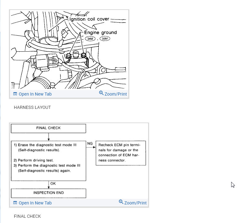

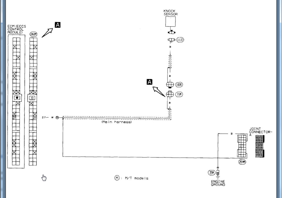

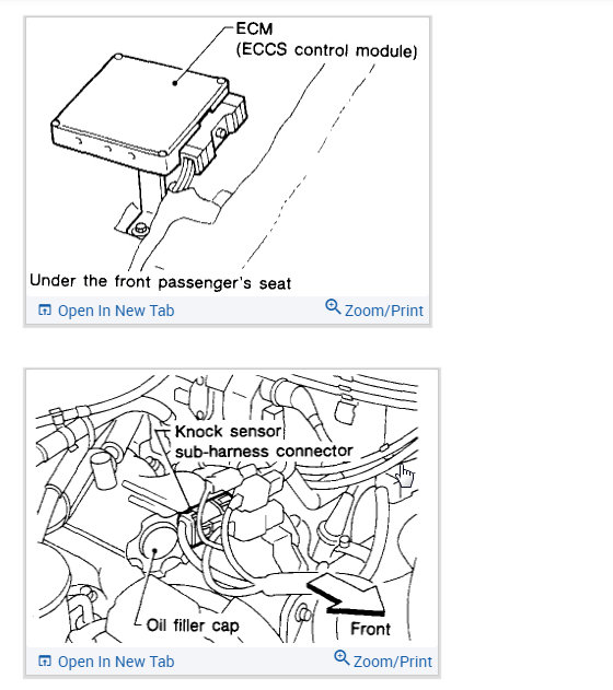

I attached the info for the sensor. It clearly states that it doesn't provide instructions on how to replace it. It looks to be under the intake manifold.

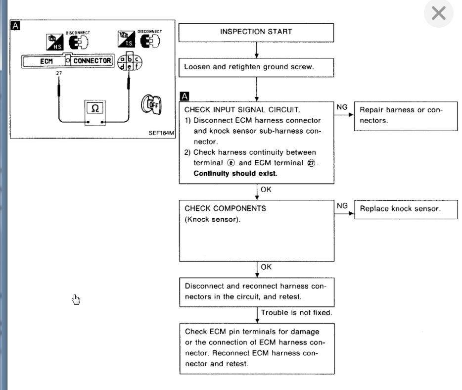

I then attached the info for the testing of this code. Let me know what you find or what questions you have and we can go from there. Thanks
