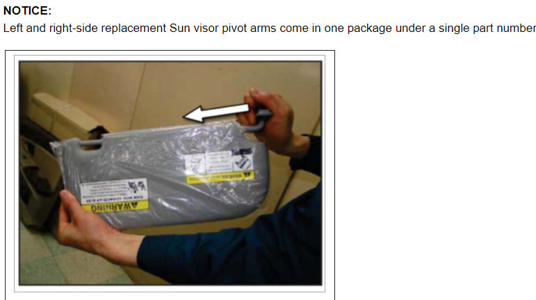

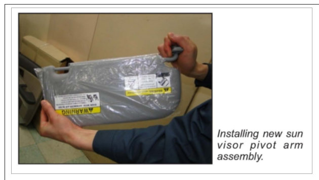

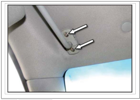

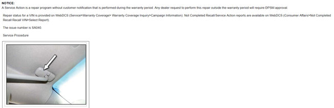

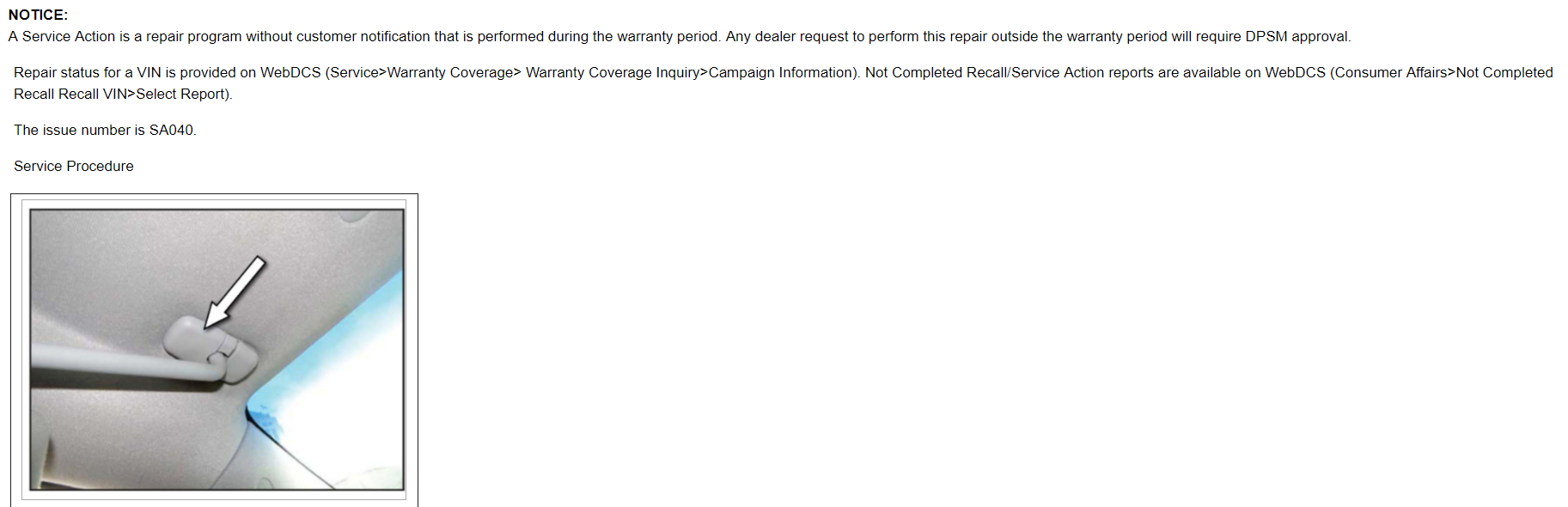

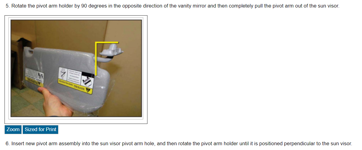

The only problem with the visor is it needs to be pushed further into the support rod here are diagrams to help you (below). Please let us know if you need anything else to get the problem fixed.
