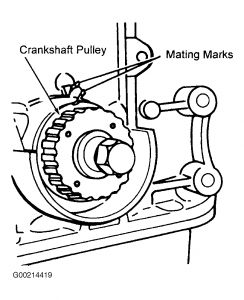

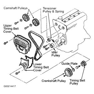

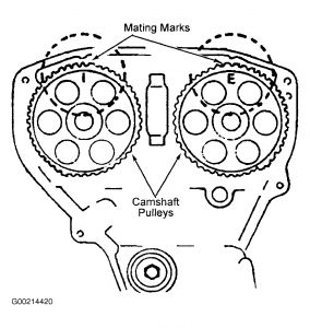

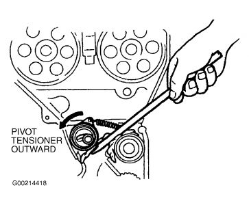

Hello
Thanks for the donation.

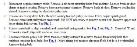

REMOVAL
FIG 1
FIG 2
FIG 3
FIG4

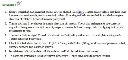

INSTALLATION
