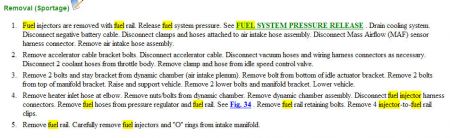

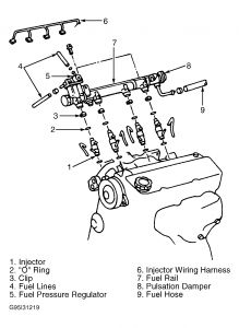

How do you change the fuel injectors on the Kia Sportage

Here is a guide to yelp walk you through the steps with instructions for your car below.
https://www.2carpros.com/articles/how-to-replace-a-fuel-injector
