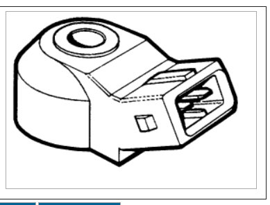

2001 Kia Sportage 4 cyl Four Wheel Drive Automatic
Where is the location of the knock sensor on the Sportage?
Mar 14, 2009 at 12:29 PM
  • CAR REPAIR CONTRIBUTOR
  • 54,474 POSTS
The knock sensor is located right above the oil filter and looks like this (below)

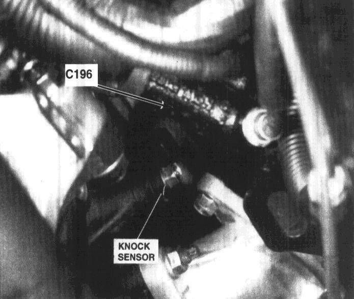

98 kia sportage- where is the knock sensor located?
Feb 19, 2018 at 12:49 PM (Merged)
  • 75,992 POSTS
Right Side of Engine (Next to Oil Filter)
BLUELIGHTNIN6
  • 16,542 POSTS
if you have a 2.0 DOHC the knock sensor is on the passenger side of the block.. from the underneath side of the vehicle you remove the support bracket that holds up the intake manifold.. and its right behind it.. you have to use a small tool to pull the wire clip from the harness and it then pulls apart.
