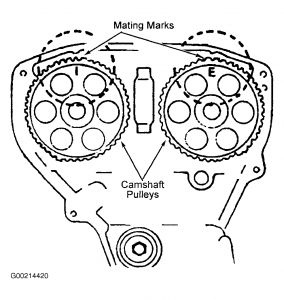

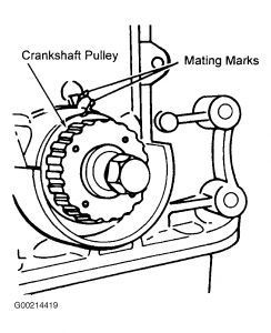

i need to know how to set the timing on my 1996 kia sportage I had to replace the water pump and forgot to mark the marks on the engine of where the timing belt belongs

Camshaft "I" and "E" marks should align with marks on rear cover.
https://www.2carpros.com/forum/automotive_pictures/266999_time_10.jpg
https://www.2carpros.com/forum/automotive_pictures/266999_time2_5.jpg
hope this helps
