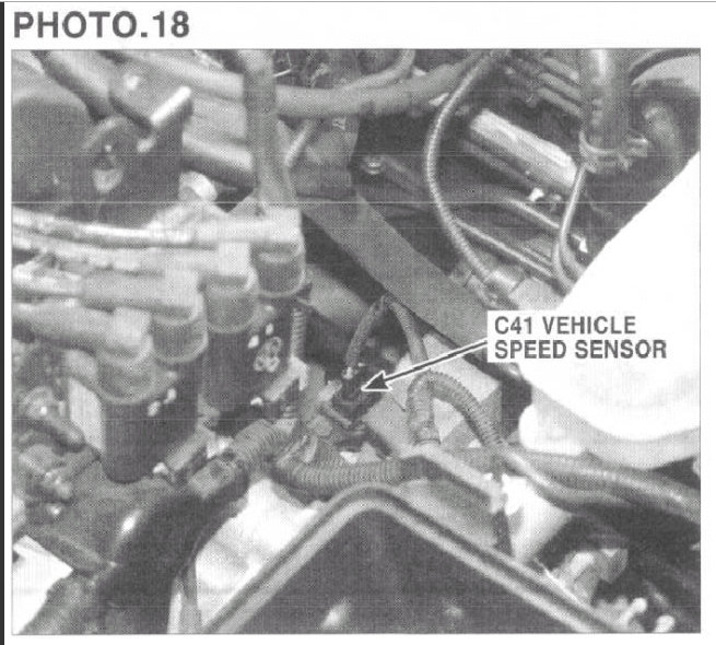

Speedometer and odometer has stopped working. Should I reset the computer by disconnecting battery? Where is the sensor located so I can get a visual to check for the obvious?
Sunday, December 6th, 2009 AT 4:47 PM
13 Replies
KEN L
  • MASTER CERTIFIED MECHANIC
  • 55,428 POSTS

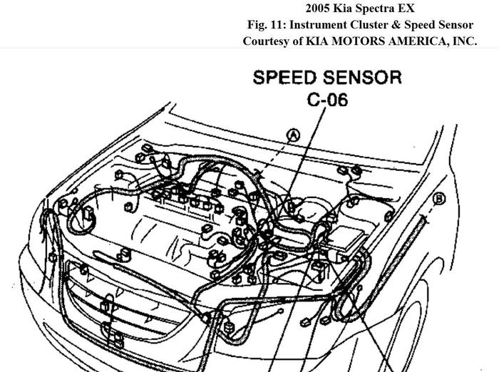

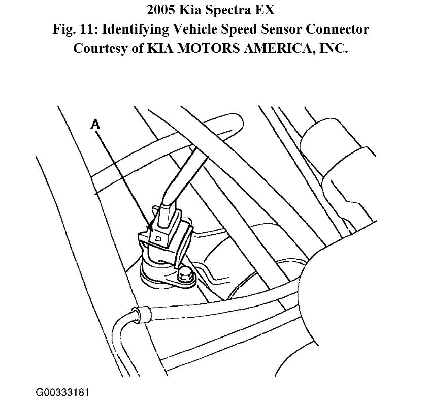

The vehicle speed sensor going out will cause the speedometer not to work. The connector is located at the read the the engine near the bellhousing but the sensor is down near the final drive axle output. This guide will show you where the connector is just follow it down to the sensor. (Below)

It usually is the cause but it could also be the wiring and only testings would confirm it.
Replacement is a simple job. Disconnect the coupler, remove the holding bolt and twist the sensor out.

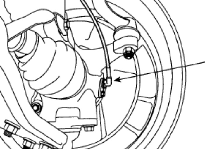

Check engine light came on. DTC revealed p0501 vss. I recently lost my front right tire due to some shrapnel on the road. I replaced the tire, but the engine light appeared after the incident. I noticed a wire hanging down near the front tire. I'm assuming this wire is the vss and am wondering if this is something I can fix myself? Is there a way to reattach this wire? I was looking online for a diagram and any helpful information. Can you help?
+1
Saturday, November 18th, 2017 AT 9:41 PM (Merged)
HMAC300
  • 48,601 POSTS
That shows wheel speed sensor and are not repairable replacement is only option
+3
Ok, most likely it is a abs issue. The first thing I would do is change the tires to the correct size.
