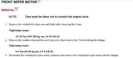

I have two questions. First question is why do the wipers stop in the up position? Is the motor bad?
Next question. How do u replace the wiper motor? Which side is the motor on?

Could be from bent linkage to bad motor. would need to visually inspect linkage first before deciding to replace motor.
