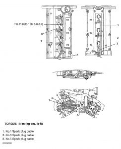

Engine Mechanical problem
2004 Kia Sorento 6 cyl All Wheel Drive Automatic
orden de encendido, instalacion de cables de corriente de candelas
Wednesday, May 5th, 2010 AT 7:13 PM
MHPAUTOS
  • 31,938 POSTS

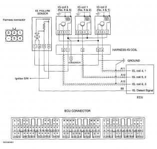

Hi there,
This is a DFI ignition so there are 3 coils, coil 1 fires cyl 1&4 coil 2 fires cyl 2&5 coil 3 fires cyl 3&6 the firing order is 123456, see pis for more information.
https://www.2carpros.com/forum/automotive_pictures/61395_kia_2.jpg
https://www.2carpros.com/forum/automotive_pictures/61395_poil_pic_1.jpg
