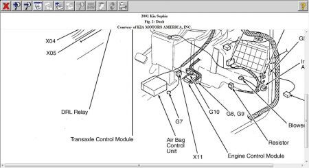

Where is the location of the engine computer?
Sunday, December 27th, 2009 AT 7:13 PM
MECHANIC
75,992 POSTS
Engine Control Module Behind lower center of dash, mounted to floor. Check out the diagrams (Below). Please let us know if you need anything else to get the problem fixed.
