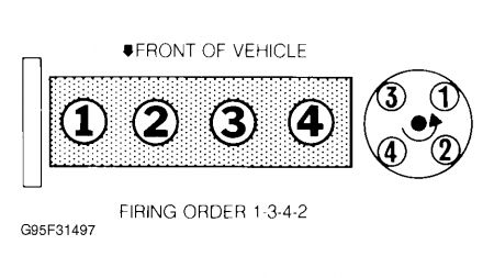

I need to know the firing order and placement of the wires on the distributer
