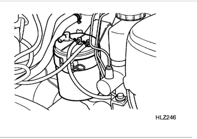

The check engine light is coming on intermittently. I had it checked at AutoZone and was told that I have a blocked Evap Canister. Exactly what is this and is/will it cause engine failure? Is an immediate repair necessary?

Yes the EVAP charcoal canister can omit raw fuel into the engine when it goes bad I would replace it ASAP here is the location and what it looks like below.

I'm having the same problem on my 2005 Sedona. Diagnostic codes were P2422 and P0342. Other than the light, car sounds like it's running fine. How quickly should this be fixed?

Yes this should be fixed soon to avoid the engine being affected by the problem.
