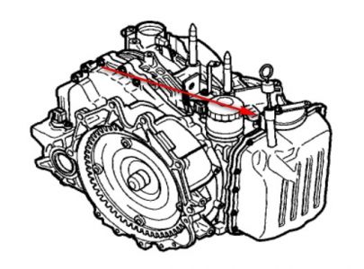

I am looking at buying a 2002 kia sedona, but can't seem to find the transmission dip stick, where is it? Is this a sealed transmission? If so how do you check to see if the fluid needs changing or it's condition?

No, it's not a sealed transmission. The dipstick come up from the side pan of the trans as shown in the picture.
https://images.2carpros.com/forum/automotive_pictures/561653_ATF_dpstick_02_Sedona_1.jpg
