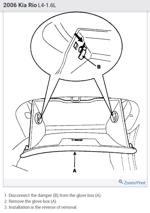

How do you replace a glove box mechanism, I cant seem to find how to get to the screws and remove it to put the new one in

The clips come right out push them toward the front of the glove box and they will unhook here is a diagram.

Thanks! Worked perfect I love this site.
