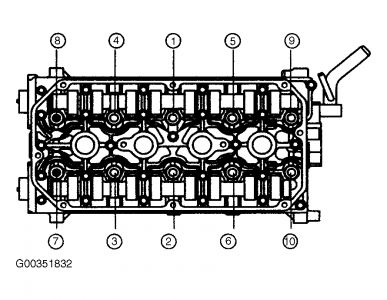

L need to confirm the tension required for the cylinder head bolts please

Hi there,
Head torque...
Step 1. 36 (49 Nm)
Step 2. Loosen bolts in reverse order.
Step 3. 18 (25)
Step 4. Torque angle 90 Deg.
Use new head bolts
