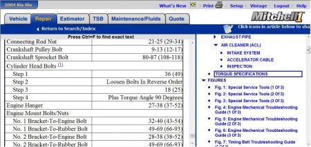

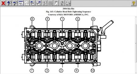

I whant the sequance tork engin and the order tork for head engin
Saturday, July 3rd, 2010 AT 11:41 AM
MECHANIC
75,992 POSTS
Sunday, July 4th, 2010 AT 5:07 AM
