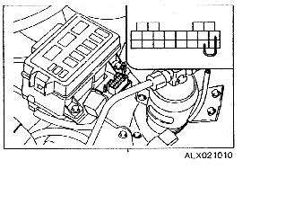

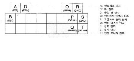

Where is the location of OBD connector for kia rio 2004?
Monday, October 5th, 2009 AT 11:32 AM
QUIFIA
MEMBER
2 POSTS
I,ve found it in engine compartment beside the fuse box with label ( Diagnosis)
