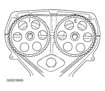

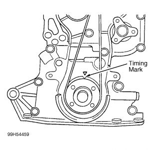

2003 Kia Rio 4 cyl Front Wheel Drive 154000 miles
where and how to align timing marks

Hi there, Is this belt being replaced due to breakage or for regular maintenance purposes, as this is an interference engine and if it has snapped while running there will be valve damage. If not i will find the relevant details and post them.

I had the pics on file,
https://images.2carpros.com/forum/automotive_pictures/61395_Graphic_154.jpg
https://images.2carpros.com/forum/automotive_pictures/61395_Graphic1_16.jpg
