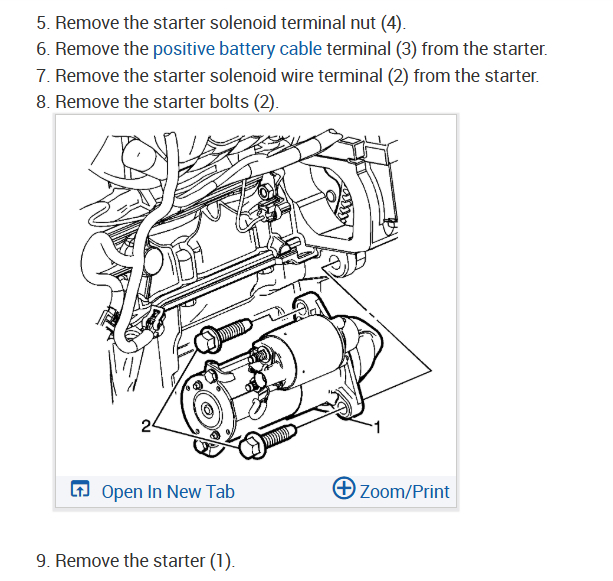

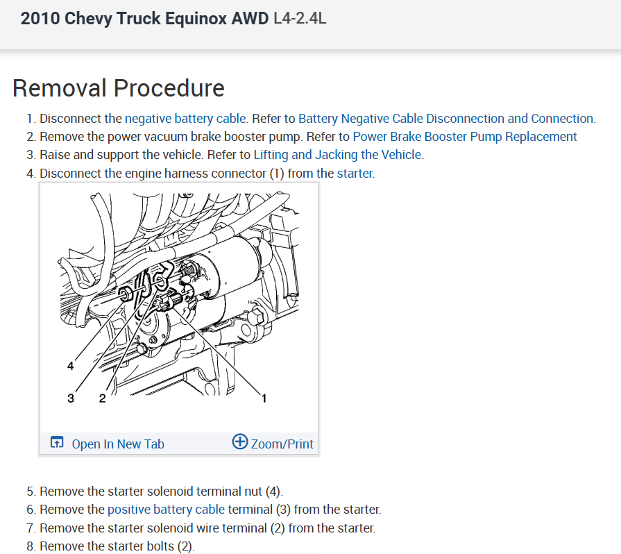

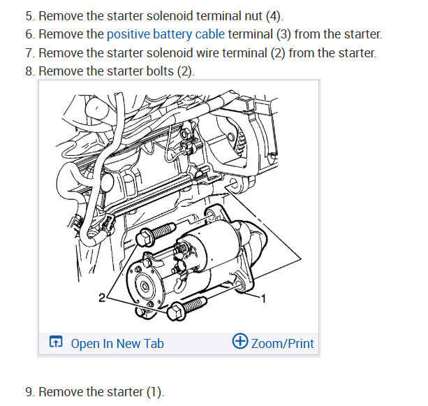

Thanks for the video. it looks like the starter has gone out. The security light is not flashing so that should not be a problem. We need to get a test light and see if the trigger wire to the starter is getting power while the key is in the crank position. This guide can help:
Here is the location of the starter and how to change it out, if there is power at the trigger the starter is bad. Please go over this video as well:
https://www.youtube.com/watch?v=6YRW8fyNudY&t
Check out the images (below). Please upload pictures or videos in your response of any problems so we can see what to help you with.
