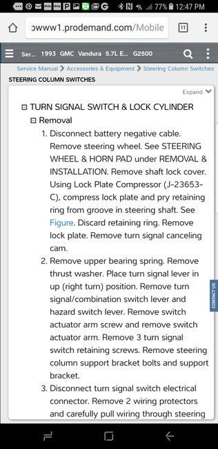

My key is stuck in the on position, it will not turn back and key will not come out.

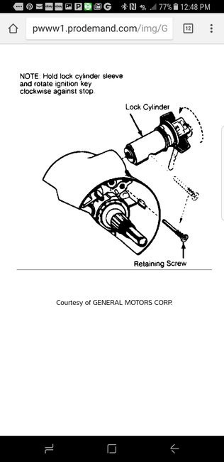

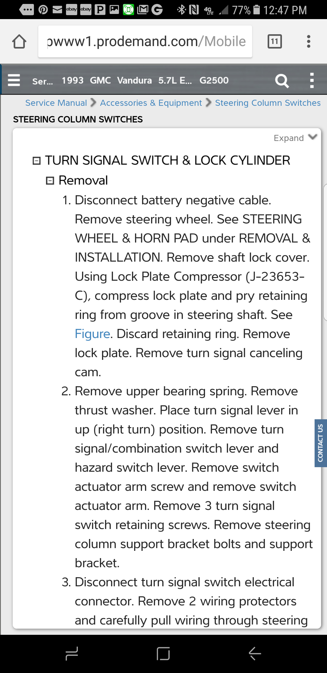

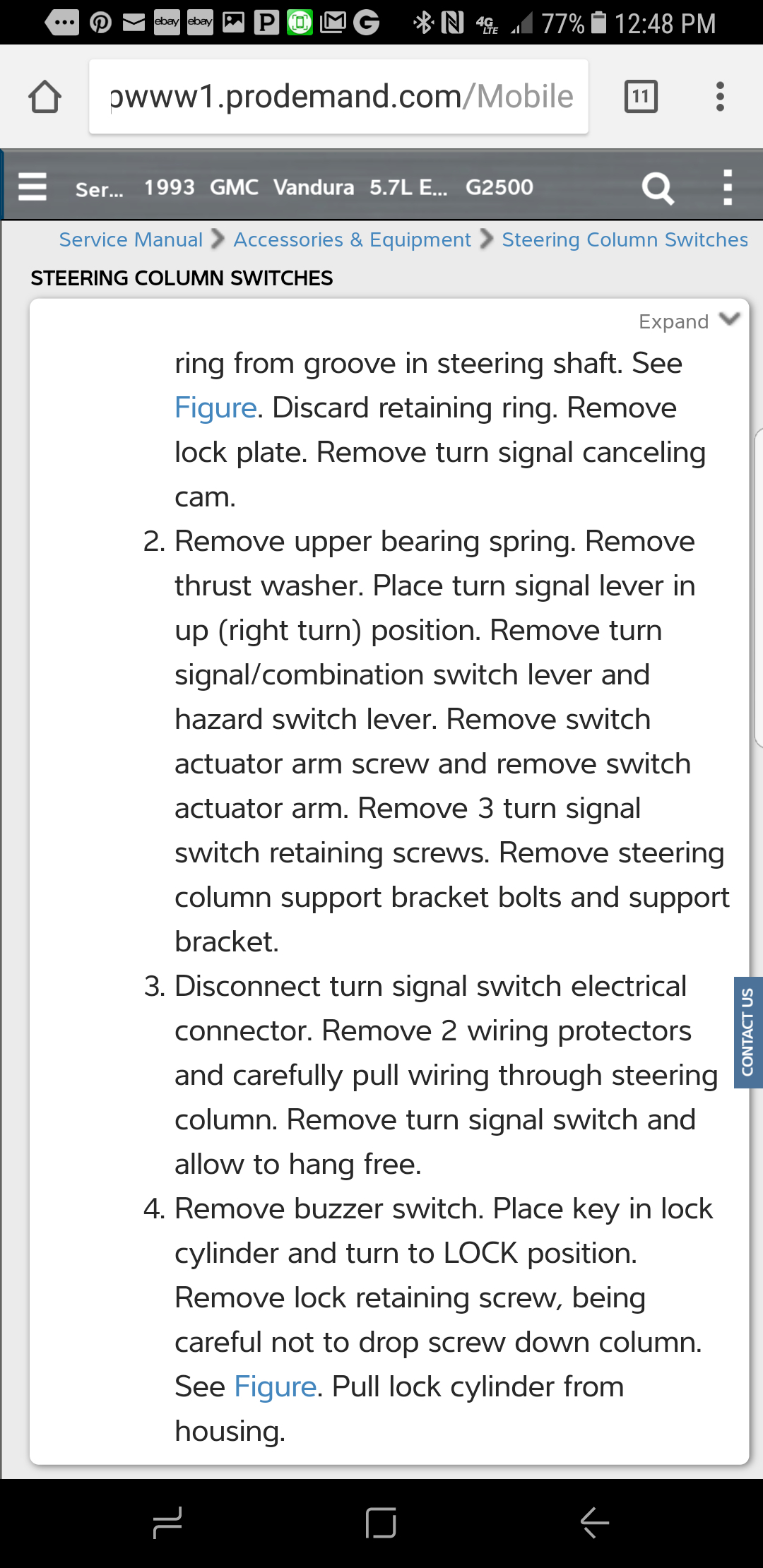

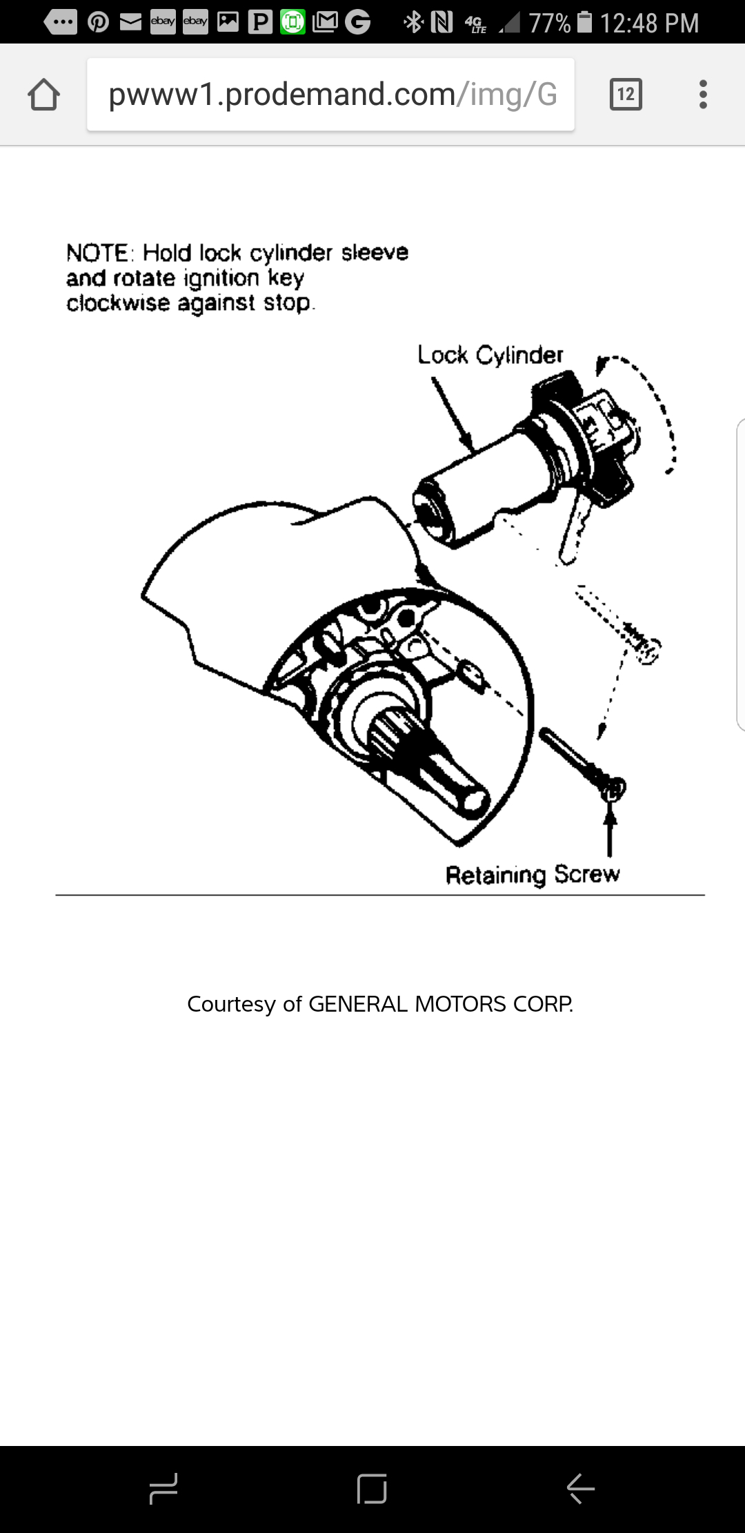

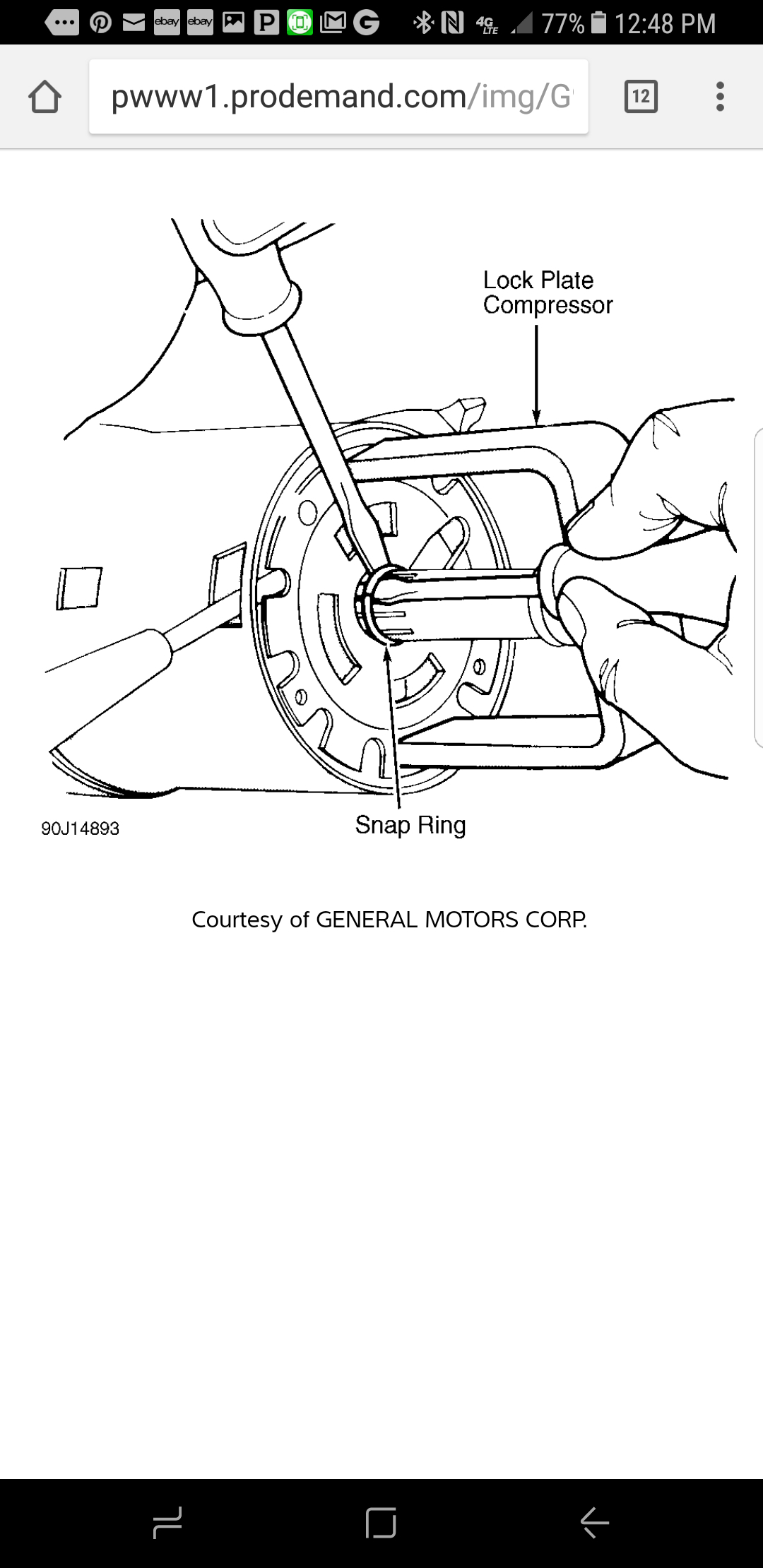

Here is how to remove your ignition cylinder most likely you have a bad ignition cylinder.

I just had a 1993 Chevrolet truck doing the same thing removed the ignition cylinder and found it was all bound up.
