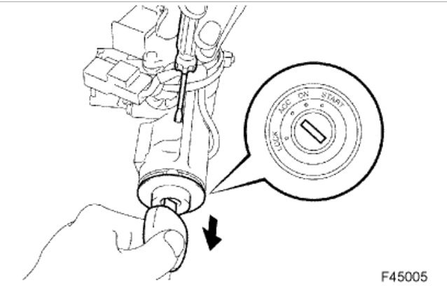

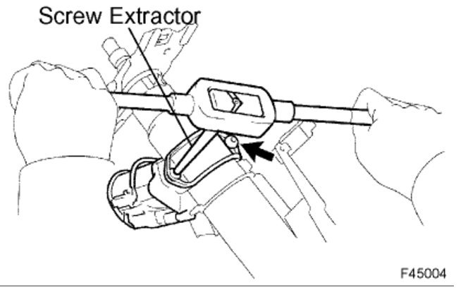

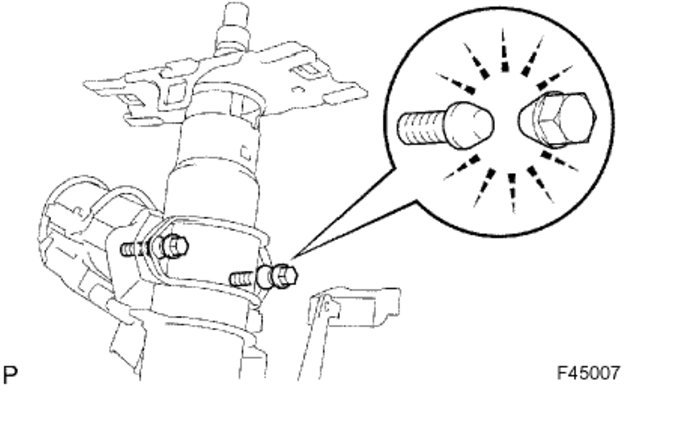

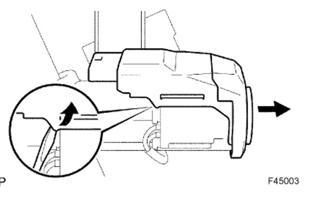

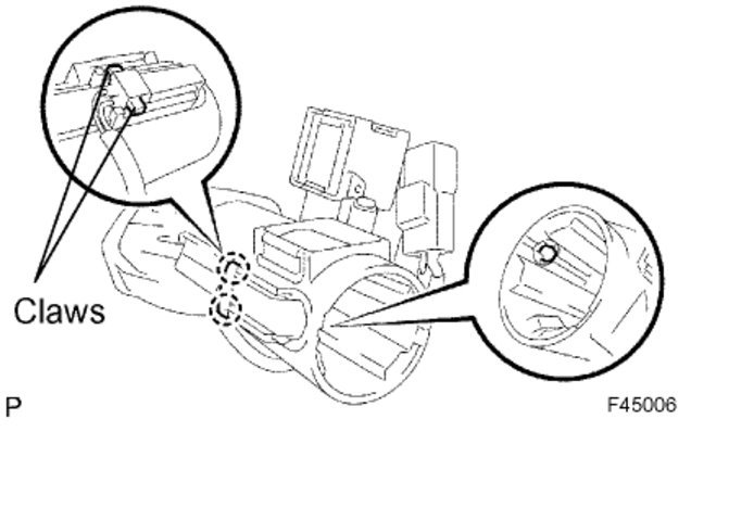

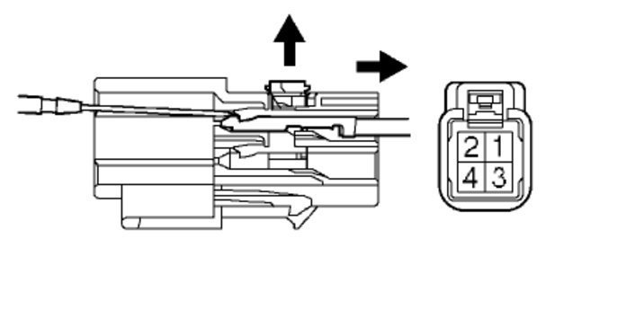

What happens is the ignition key gets worn out so its gets stuck. Here is a guide to help you get the ignition tumbler changed out.
Aug 12, 2017 at 6:57 PM
