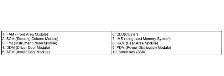

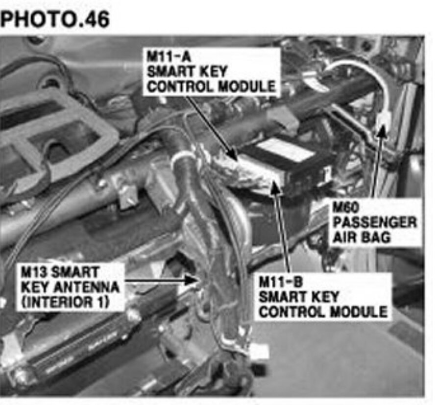

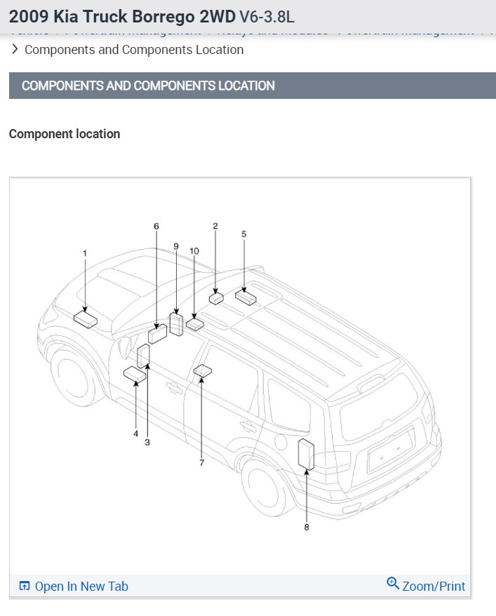

It does sound like the smart key module SKM is going out but to be sure we need to do a CAN scan; you can get a CAN scanner (Controller Area Network) which will work on most cars from Amazon.
https://youtu.be/u-4syLc-ifQ
here is how to change the SKM out in case a code comes up for it, you can get a preprogrammed unit by searching Google or Ebay. Check out the images (below). Let us know what happens and please upload pictures or videos of the problem so we can see what's going on.
