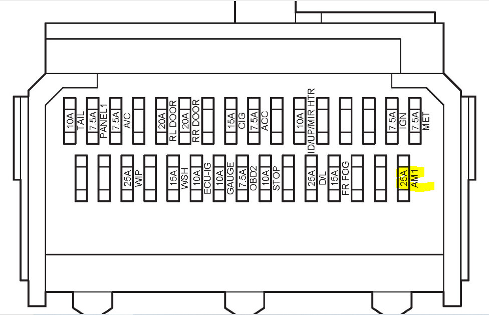

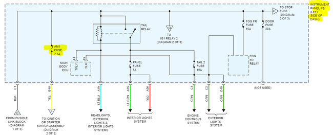

Check the AM1 fuse in the interior fuse box. I attached a pic below showing the location and the schematic. If the fuse is good, confirm there is power to and from it.
Let me know what you find.
