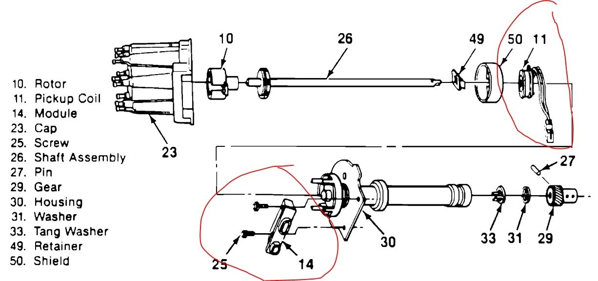

Have you checked the pick-up coil and ignition control module in the distributor? It sounds like it is related to one of them. Often times the ICM will fail internally and be affected by heat. The pick up can become corroded and not make proper references.
Let me know. I attached a picture of the distributor below. I circled the two components I am referring to.

Would it still be getting fire if that is bad? Because I checked and it's still getting a good spark.
Thursday, September 3rd, 2020 AT 9:38 AM
  • 110,194 POSTS
Welcome back:
No, if it was bad, you would lose spark. Have you checked and confirmed fuel pressure and checked for an injector pulse when it happens?

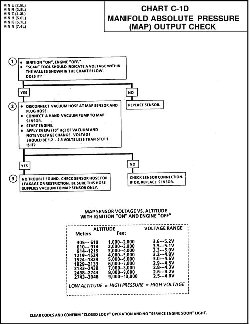

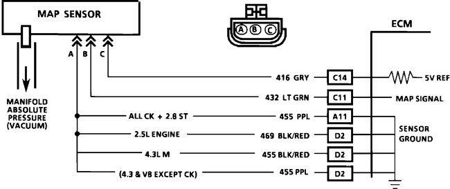

  • 110,194 POSTS
As far as the sensor signal, here are directions for testing it. However, it requires an OBD1 scan tool.
_________________________
Pic 1
Pic 2
TEST DESCRIPTION: Numbers below refer to circled numbers on the diagnostic chart.
1. Checks MAP sensor output voltage to the ECM. This voltage, without engine running, represents a barometer reading to the ECM.
2. Applying 34 kPa (10" Hg.) Vacuum to the MAP sensor should cause the voltage to be 1.2 - 2.3 volts less than the voltage at Step 1. Upon applying vacuum to the sensor, the change in voltage should be instantaneous. A slow voltage change indicates a faulty sensor.
3. Check vacuum hose to sensor for leaking or restriction. Be sure no other vacuum devices are connected tot he MAP hose.
Let me know if that helps. If you can provide the code or codes you found, I may have a specific diagnostic flow chart for it. Otherwise, this is what I have.
I hope it helps. Let me know.
