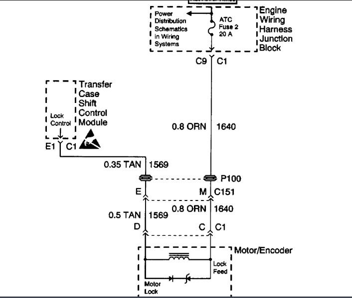

In June 2019 4wd quit working. I replaced front actuator that did nothing. So I replaced transfer case shift motor the 4wd drive started working properly.
A month or so later the atc under the hood blew. Replaced fuse worked for awhile.
Now it blows the fuse all the time some times it work for a day or two other times it blows as soon as I turn the key on.
I traced all the wires and can not find any obvious shorts in the wiring harness.
I got the codes scanned 12-06-2019 and came up with 4
c0327
c0387
c0323
u1096
I am lost and looking for any help I can get. I have a new TCCM but not thrilled in putting in a $250.00 part if this is not going to fix my problem.

What fuse number is the one that is failing? ATC is the power for the encoder motor. Disconnect the motor and see if the fuse still fails.

It's the 20 amp atc under the hood it does not have a number. If I unplug the encoder motor what should I do to test and see if the fuse blows? I unplugged it last week cycled threw the 4hi 4 low 2 hi and auto it did no blow the fuse but I did not drive it. Then I plugged it back in uses 4 hi twice then the third time in blew atc fuse.
Tuesday, December 10th, 2019 AT 4:09 PM
Yes, unplug it and then install the fuse and see if it fails.
If it does, then you have a wiring issue between the fuse block and the motor. If it does not fail, the motor is drawing too much amperage and causing the fuse to fail.

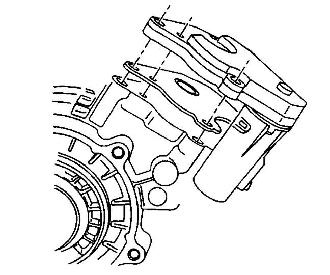

Okay. I have read a lot of different post about this. Some people are replacing the transfer case control module. It's the only part I have not replaced. I read that even new encoder motors fail. I know when I replaced the encoder motor 6 months ago it worked for a while before it blew atc fuse. Have you heard of a lot of new encoder motors going bad?
Tuesday, December 10th, 2019 AT 4:22 PM
I have put brand new parts on that were defective out of the box.

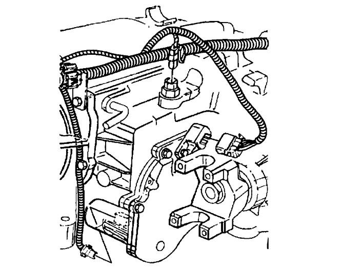

Okay, there are 2 plugs on encoder motor. The one that goes to the bottom and 1 that goes to in the side near the top. I unplugged the wires that run to the bottom and fuse has not blown yet. Is that the right wire?

The 4 wires that run to bottom of transfer case that I have unplugged are red, black, orange and yellow.

The plug that I did not unplug are
Brown with white stripe.
Black with withe stripe.
Blue with white stripe.
Red with white stripe.
Green
Yellow with black stripe
+1
Wednesday, December 11th, 2019 AT 12:39 PM
Yes, that is the correct plug.
I would drive it around to be sure the fuse does not fail.

Okay, then the encoder motor is causing the fuse to fail.
I would replace the encoder motor.

Okay, I replaced encoder motor. Worked for about a week then blew fuse again. For the week it worked I used 4wd a dozen times and every thing worked great. Friday put it in 4wd blew the fuse. Do you think it could be transfer-case control module?
Monday, December 30th, 2019 AT 3:56 PM
It sounds like the motor is pulling too much current to operate. That would make me think the it could be the transfer case itself. Something may be binding up and causing the motor to draw more current than the fuse allows.
