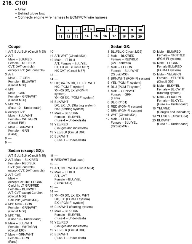

How do I wire the c101 plug to the k24 engine harness?
Sunday, April 27th, 2025 AT 12:51 PM
KEN L
MASTER CERTIFIED MECHANIC
55,522 POSTS
Very carefully! Lol sorry, it's Monday! Here is the information you need to fix the problem. Check out the images (below). Let us know how it goes.
