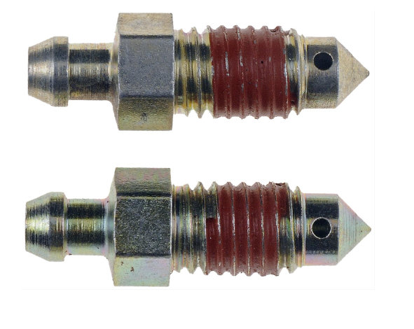

Just replaced OEM clutch with stage clutch kit 2 kit, there is no pressure when I press the clutch pedal?

Just replace the clutch on my car listed above OZ Rally, when I press clutch to the floor there is zero pressure

It sounds like you will need to bleed the clutch system.
Clutch issues:
https://www.2carpros.com/articles/clutch-doesnt-work-sometimes-or-not-at-all
Possible air in the hydraulic system will cause no pedal pressure
A good tech article:
https://www.evomoto.com/tech_articles.php?tech_article_id=17
How to use a speed bleeder:
https://youtu.be/fEBE_NqLXJc
Hope this helps.
Cheers, Boris
