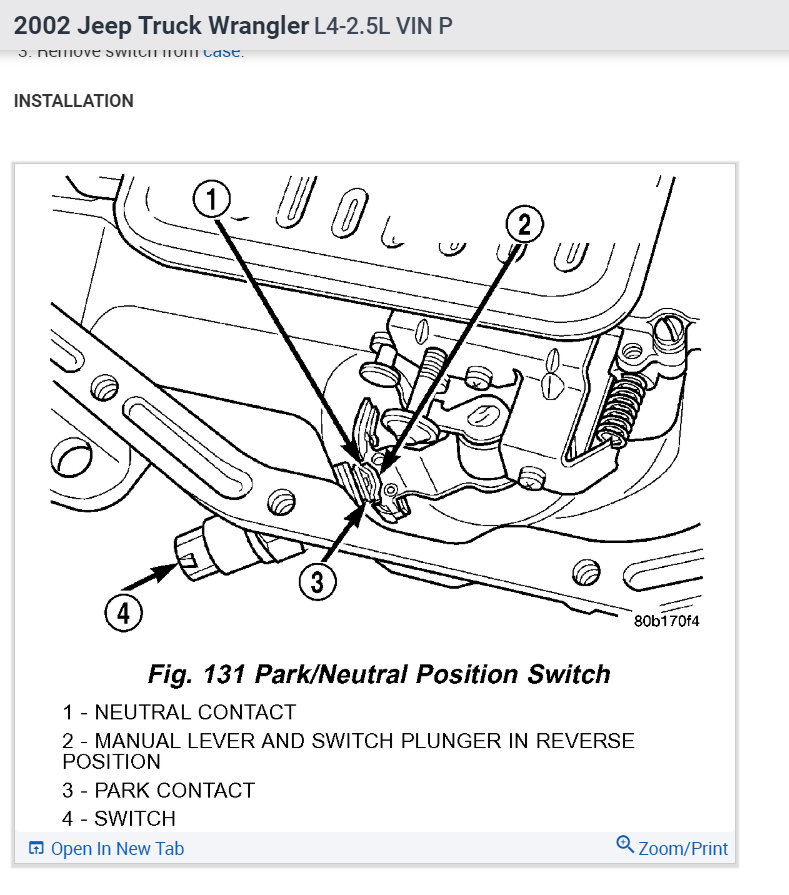

Inst pan will light up but starter is not geting any power. Engine will start up when starter system is bypassed and started will turn when removed and tested. Think it is the neutral safety switch but dont know where to find it.

The neutral safety switch is located on the transmission here is a diagrams to show you what it looks like. Check out the diagrams (Below). Please let us know if you need anything else to get the problem fixed.

How do I get to the neutral switch to replace it and if it is bad would it keep the back up lights from working?

since its equipped with an automatic transmission, yes a faulty Park / Neutral Position Switch will also cause the back-up lights to fail. your vehicle's PNP switch is located on the left side of the transmission.

I looked on the left side & didn't see it. Where on the transmission do I need to look?

Look just behind where the linkage is fastened
