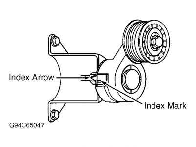

How to you get the belt to go on. Do you unscrew something or pull on something so the belt will slip on? I have the belt routing diagram

Here is a picture of the automatic tensionier. Place a box end wrench on the pulley bolt and turn it to move the thensionier and loosten the belt.
Let me know if this helps.
