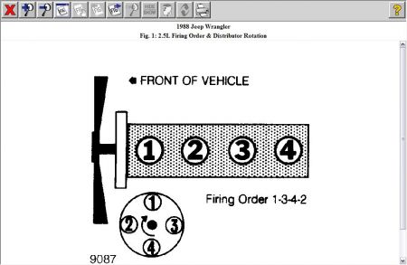

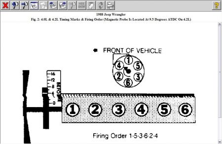

I would like to know the firing order for this car.
Saturday, December 8th, 2007 AT 11:57 AM

Available engine liters for this year - 2.5/ 4.0 /4.2 see below
