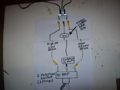

Is there a way to relocate the floor mounted dimmer switch

Yes it can be done...see my profile....neighbor put a 2 position swich on his dash, left of steering wheel, inches? down from windshield separation....can tell/ help you more....possible take pic and post if you want.........I ask you as I asked him.....WHY ???

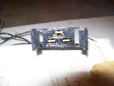

I understand that it can be done,(from turddog), but need more info - such as type and size of switch, and maybe a small wiring diagram. You might guess that I am a "rookie" at this stuff. I want to do this because my feet are to big to fit between the side panel and the clutch. Ron

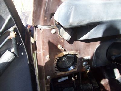

RON, My neighbor, Ron, is an electrician.He has a 1983 CJ 7.(I am a plumber, but have and done many CJ modifications on mine and others) I will take PIC really soon of his set-up. Wiring this is REALLY a NO-BRAINER......will show you this also in a pic..........verify your Jeeps NOMENCLATURE....unclear in post.

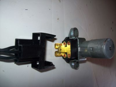

Kinda all we could do in a hurry. This should be simple enough. Keep in mind this is neighbors Jeep,in pic, and is not a reflection on mine. ALL other pics, I constructed w/ marker + wire connectors....may have to zoom in !!! IF YOU can "PM" me with your Email address can send you lots of pics w/ super "NELSOMATIC" modifications. His switch mounted Left and right. I WOULD HAVE IT LOW down....HIGH up!!! What I show can be removed and put back original w/ no cut wires!!! OUTER 2 wires are SWAPPABLE they will just swap H and L on the actual switch......turning the switch around does same thing. By GOSH , I get very few replies.....spent some time here! BETTER REPLY!!!!!!!!!........CJ and WRANGLER 2 different animals....didn't know which you had!! Love, Turddog I would have installed an angle bracket under dash w/ switch, Ron don't care about hole, look at his speaker!

Wind blew my paper as I took pic, OH WELL!!!.....Think you get the picture.
https://images.2carpros.com/forum/automotive_pictures/411289_2car_004_1.jpg
