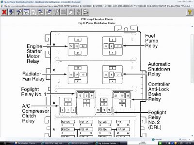

How to replace or get to cooling fan relay 1999 Grand jeep cherokee limited 4x4
Friday, March 28th, 2008 AT 12:26 PM
2 Replies
MASTER TECH DAN
MECHANIC
83 POSTS
The relay is behind the bumper cover you can see it but you need the either cut the cover a little or remove it
Friday, March 28th, 2008 AT 12:29 PM
MERLIN2021
MECHANIC
17,250 POSTS
Look in the power distribution center under the hood.
