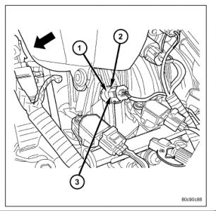

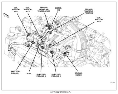

Hello could you send a picture or tell the exact location of iat senser on 06 jeep liberty anniversary edition
Friday, January 15th, 2010 AT 5:44 PM
MECHANIC
75,992 POSTS
The intake manifold air temperature (IAT) sensor (1) is installed into the left side of intake manifold plenum.
