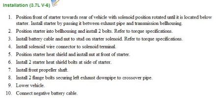

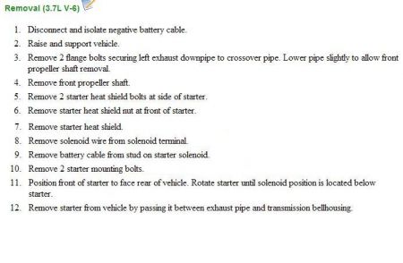

How to change out the starter
Wednesday, July 29th, 2009 AT 2:33 PM
BLUELIGHTNIN6
MECHANIC
16,542 POSTS
Wednesday, July 29th, 2009 AT 3:05 PM
